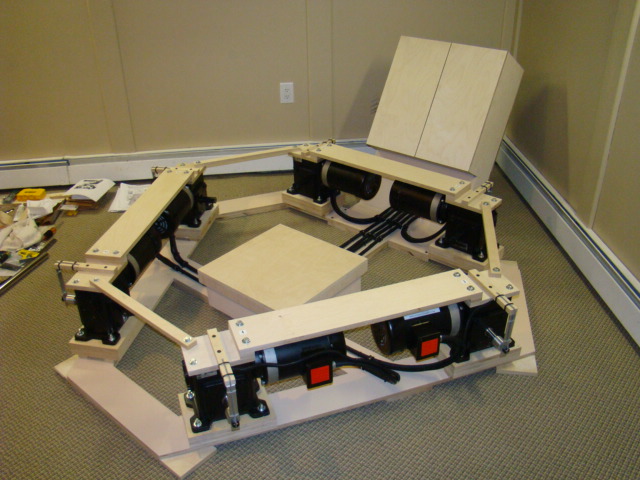

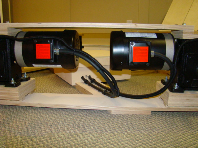

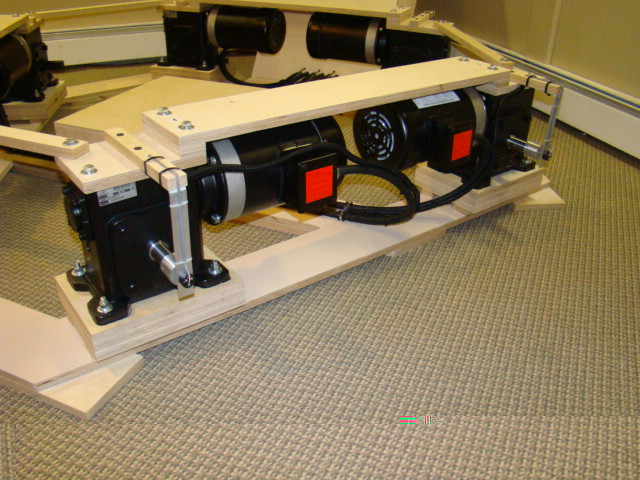

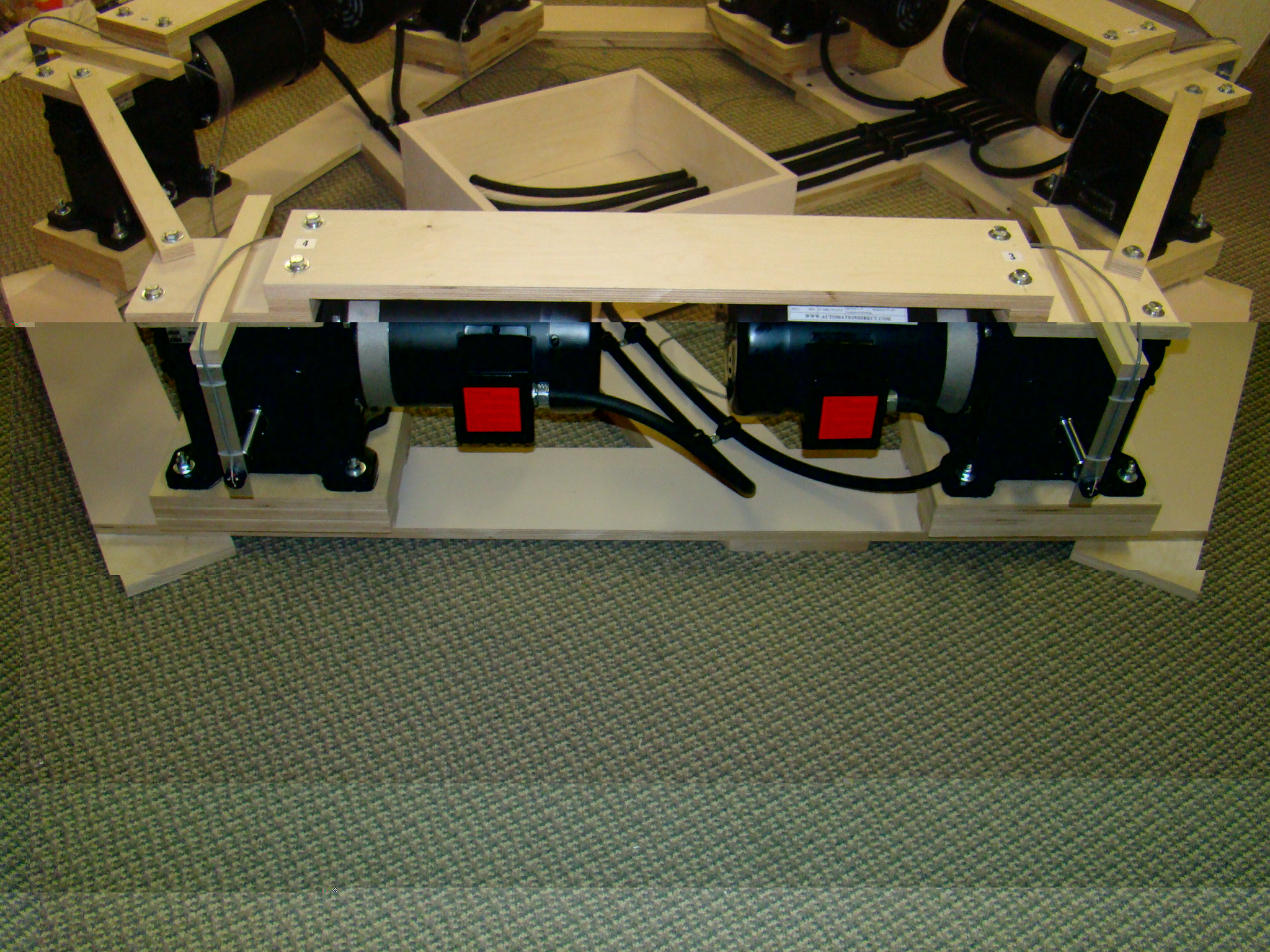

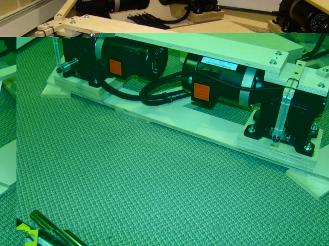

Postby Stevant1 » Thu 11. Sep 2014, 13:09

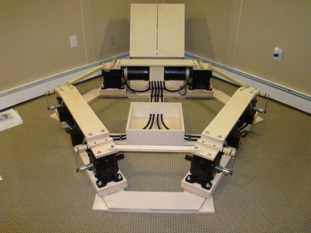

Ok.......motors are mounted and the wiring is hooked up! I also started wiring the sensors but I'm still waiting for the adaptors before I finalize and route the wires. I attached a few photos. Still waiting for my brake resistors and my 24v power supply. Looking forward to getting it all together to start testing. :)
I'm putting a panel over the interior center of the platform for aesthetics. It will be triangular in shape to cover a lot of the flooring and wiring. Just trying to make it look clean and neat. I'll complete once I run the wires for the sensors.

Postby DoctorD » Thu 11. Sep 2014, 13:22
Holy shamoly Stevan :)
The motors make it look even more awesome. I'm really liking the timber approach, it certainly carries an element of beauty.
Thanks for the progress photos.

Re: Wood 6DOF Platform (13 ply Laminated Birch)

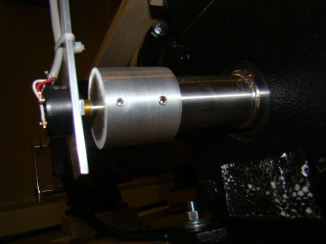

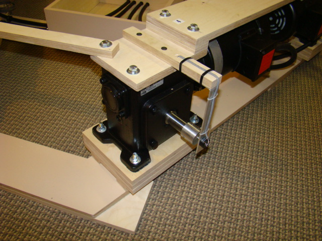

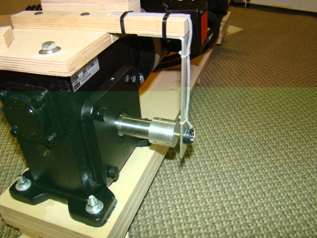

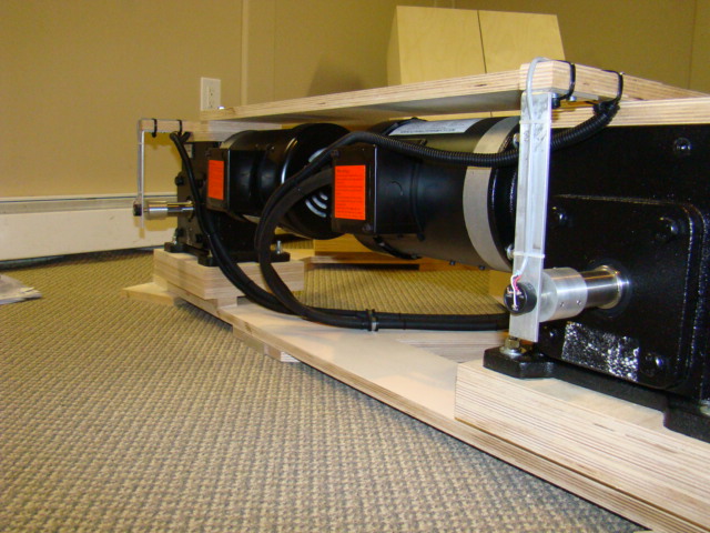

Postby Stevant1 » Fri 12. Sep 2014, 03:03
Picked up my shaft reducers for my position sensors. They came out great. I had them put 3 set screws around the circumference on the gearbox shaft and the sensor shaft side. Thanos mentioned it would be easier to adjust the center point if we are able to rotate the shaft reducer during setup. I started running the wire for the sensors, need to get some stuff at the store tomorrow to route the wire neatly back to my inverter box.
Some pics below.........

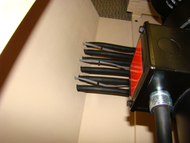

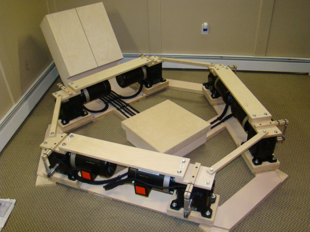

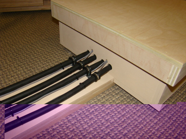

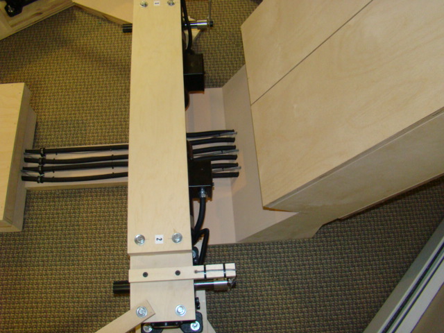

Postby Stevant1 » Sat 13. Sep 2014, 17:20
Hi all,
I'm pretty much done with my lower platform. I ran all the wires as you can see in the photos. I like that they came out, nice and neat. Tripping hazard otherwise. I ran my sensor wires into my cabinet. Once my board comes in from Thanos I'll be ready to hook it all up and run some tests. I took a lot of photos at different angles.
Good times ahead, I hope!! :D
