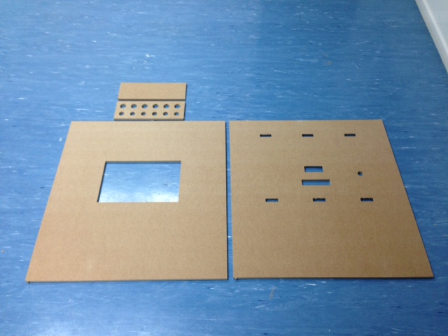

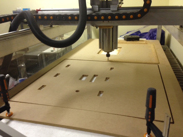

I've just finished a run on the CNC machine I designed and built a few years back. This is the 1st of two 1800x900mm MDF sheets to be cut in order to form the Electronics Enclosure.
Here's a pair of photos showing the output:
The panel with multiple rectangular holes will be the enclosure's door. Holes are to allow viewing of the 6 VFDs, the LCD from Thanos' AMC1280USB, safety stop button and a bank of selector switches.
