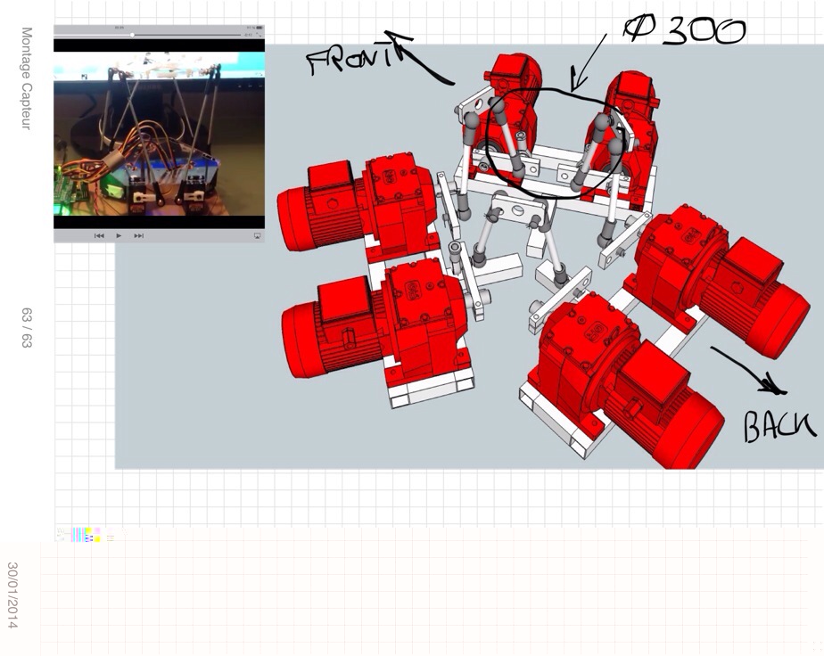

I probably change a little bit the motors placement following the mini-servo stewart plateform made by Richard with an amc1280usb.
Video :
Here the drawing according to the mini servo platform.It's more compact than the first one on the first post of this topic.
New design

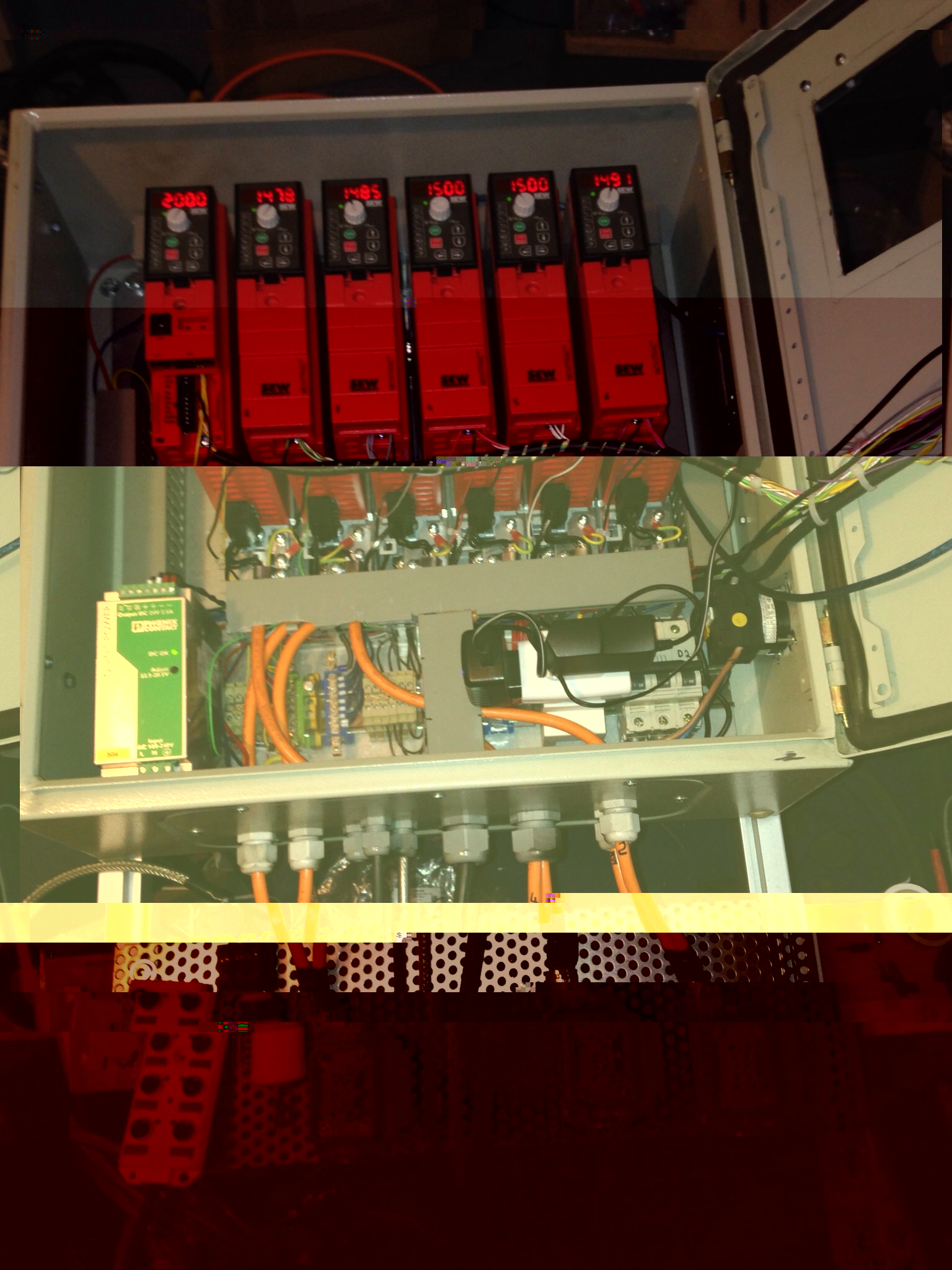

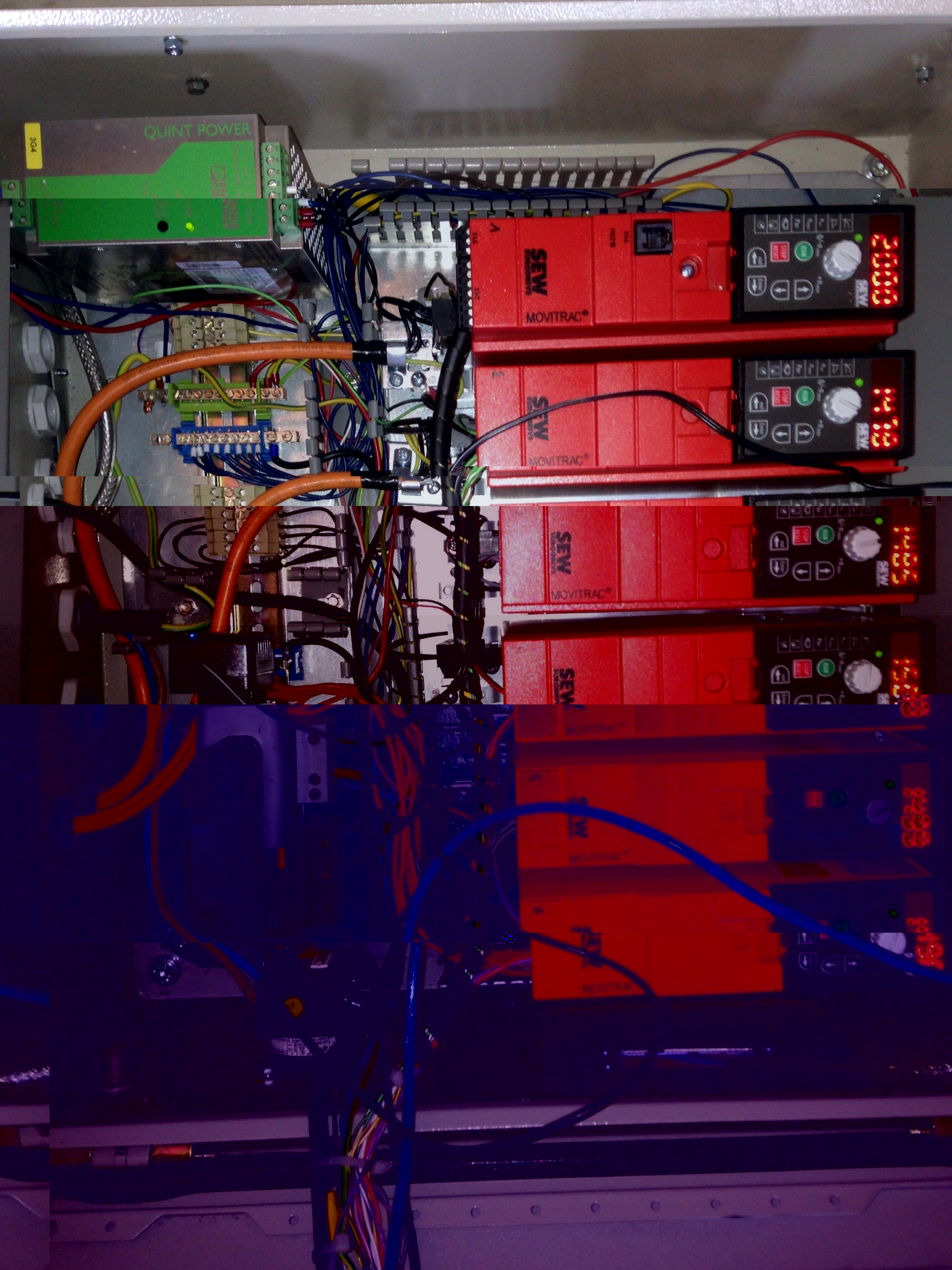

Postby vicpopo » Tue 25. Feb 2014, 13:11

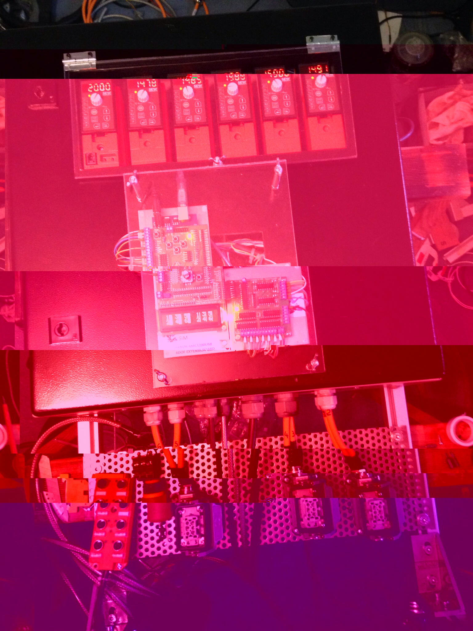

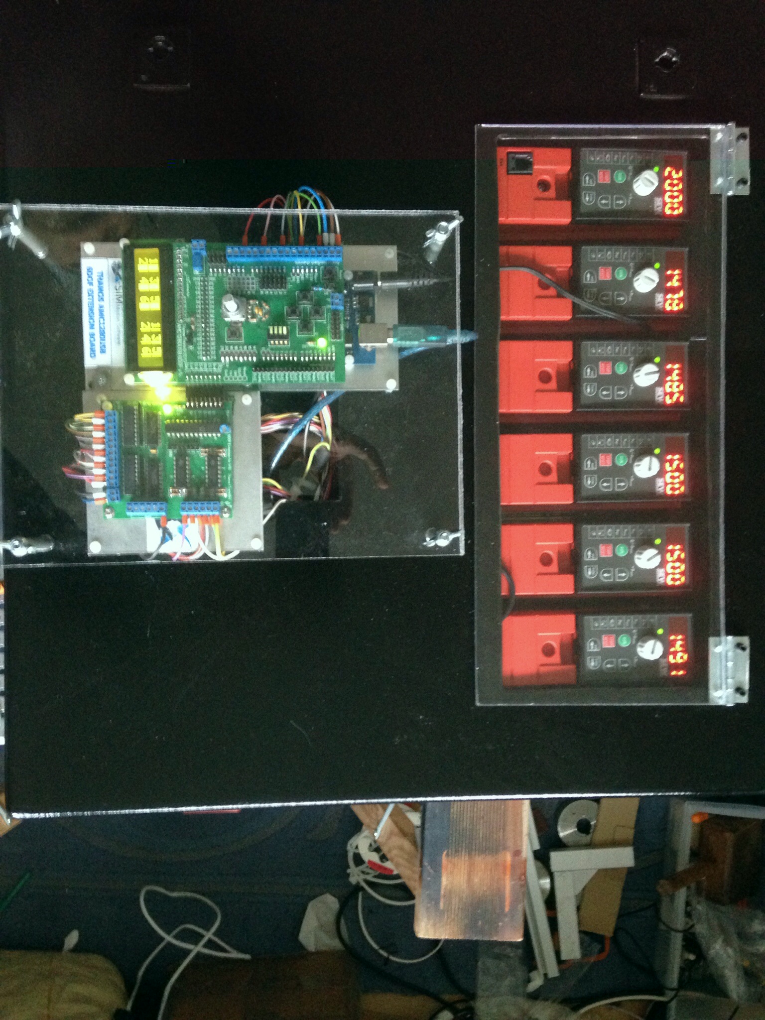

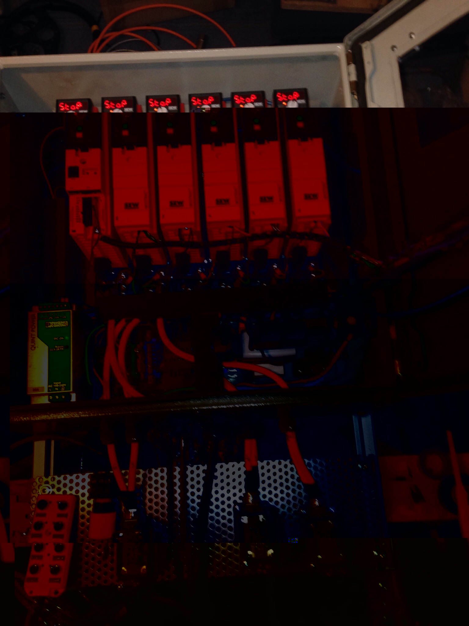

Hi Guys,
Some news from my simulator building.I quiet finished to connect my electrical box.I was a little bit afraid before the first switch ON ... And everything runs well.I didn't cut off the home net and that seems to be ok for the wiring.
I changed the wiring for Enable/Start for the inverters .Now I used instead each intern 24v inverters the psu 24 v to switch on all the inverters.
Below some pics about all stuff and the last ones with electrical box powered ON.
Switch On inverters
Wiring
Wiring1
Output inverter connection to ac motor
Blindage = shielded cable
Powered ON
Box powered on
Re: 6dof motion simulator
Postby vicpopo » Sat 1. Mar 2014, 19:45
Hi ,

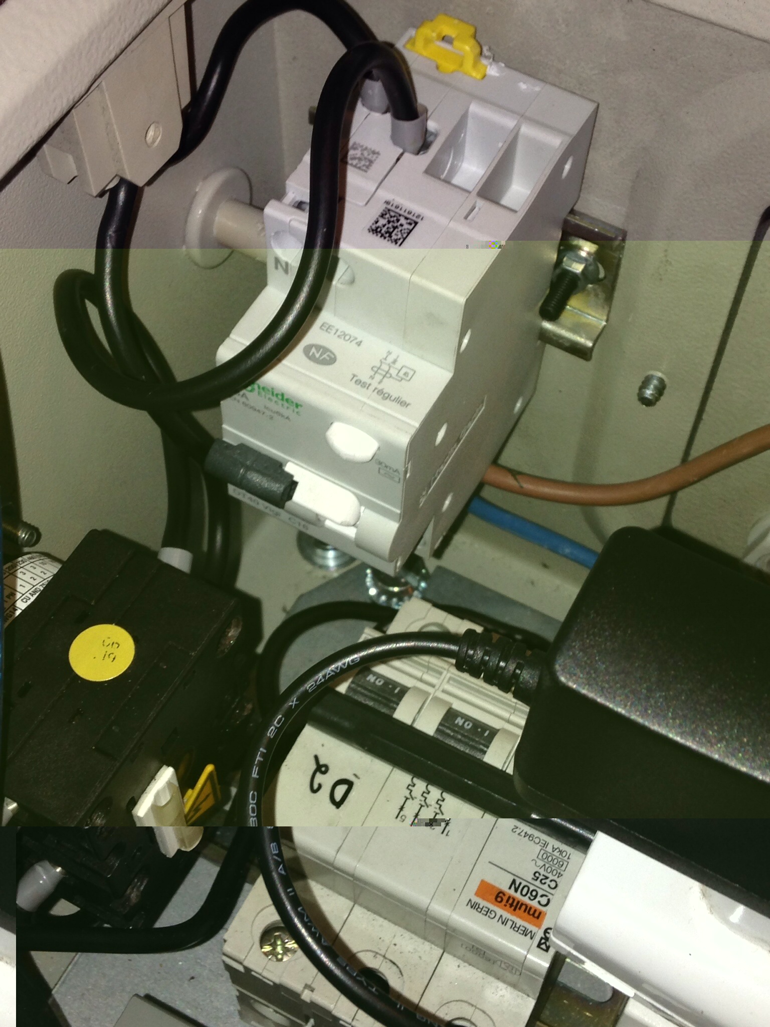

A point from my simulator .Now I finished to build my electrical box.
I tested and anything seems to be wrong wired , because my neighbours still have lignts in their home !! Ouah :lol:
I added a differnetial breaker 16A/30mA , because I have one and anything shut down.
Downside there are the 3 Harding plugs for 2 motors connections , the Enable/Start button which drive simultanuously the 6 inverters and the distributor where I will,plug the 6 sensors cable for motors positioning.
Now the next step is to connect one gear motor I have and test . I have to buy now the last 5 gear motors .
