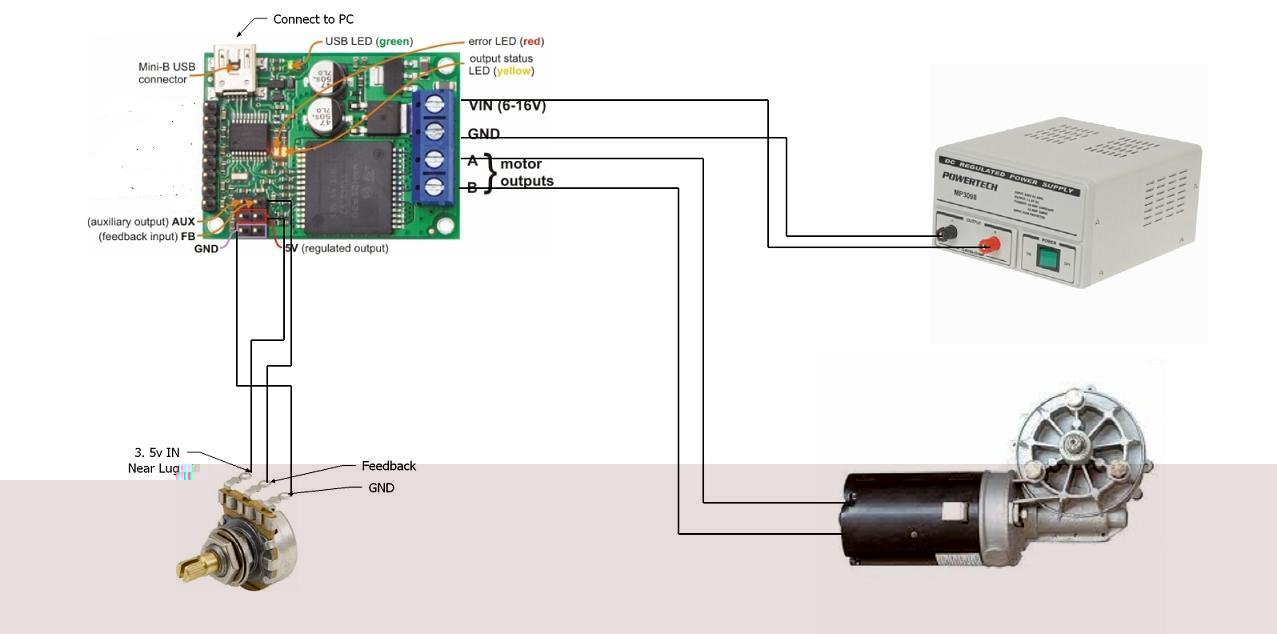

Buy JRKS here http://www.pololu.com/catalog/product/1393
wiring diagram for jrk.
JRKS are controller, microprocessor and h-bridge in one. 7 wires, simple USO commands to set to x-sim, one usb cable. Basic PID config setups.
They will run 14v at 30 amps continuous with heatsink and fan cooling.

i am michael,here is my questions. :lol: First,i wonder if to the JRK's left is a interface board in Update 09.07.12's picture :?: and where can i buy the board?Second,i have difficult in dealing with the connectiongs between each parts in the electronic board ,so can you show our fresh men some more distinct pictures for the connections or give us some hints in your electronic board? Sorry for i am fresh man and have so much questions ,i and my friends really hope we can make our 2DOF cool seat with your guys' help!!! :D
Hi Michael,
The "interface board" next to the JRK's is a simple (powered) USB hub which I took out of it's case.
Regarding the wiring diagram: motiondave's schematic is exactly what you need.
