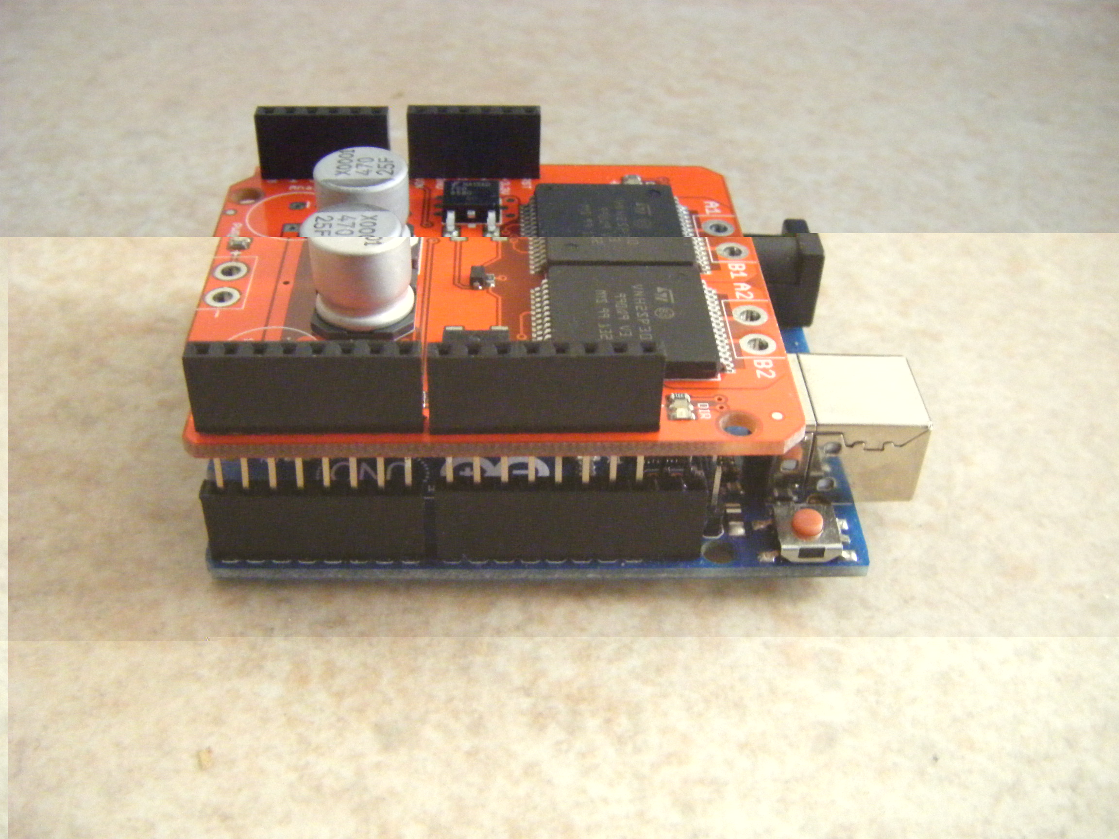

[*]Electronic cards : Arduino + Motomonster
An Arduino card linked to computer #2 with a USB cable.
The Arduino controls the MotoMonster shield "motor driver board".
The power board Sparkfun "MotoMonster" drives the two motors (12V 47A = 575W) according to the instructions of the Arduino (5V 5mA = 25 mW).

Cards: Arduino and MotoMonster:
here is the wiring diagram I followed from Lipide512
1505
I chose not to stack the two cards although it is expected to:
- I wanted to keep me a chance to reallocate the outputs of the Arduino
- I wanted better cooling system (so I raised the motomonster)
If you bought the Motomonster board, the simpliest is to stack it onto Arduino !
If you don't, you have to follow the following pinout :
Arduino and Motomonster have same pin's number !
connect together
Arduino .../...Motomonster
......GND <-> GND pin
........5V <-> 5V
.....pin 4 <-> pin 4
.....pin 5 <-> pin 5
.....pin 6 <-> pin 6
.....pin 7 <-> pin 7
.....pin 8 <-> pin 8
.....pin 9 <-> pin 9
pin 13 is not needed
on the pictures, I've soldered more wires (but they are unused wire...).
Alternative: the olimex VNH3SP30 works like Motomonster VNH2SP30: 1 pin for PWM speed, 2 pins needed for direction
and can handle 24V
and so the code is compatible!
specs https://www.olimex.com/Products/RobotPa ... h3sp30.pdf
The Olimex board (integrating VNH chip) pinout is:
Olimex pin 5 = inA motor1
Olimex pin 4 = inB motor1
Olimex pin 6 = pwm1
Arduino /.. VNH3SP30 motor1
Ard GND <-> Olimex GND pin
Ard 5V <-> Olimex 5V
Ard pin 4 <-> Olimex pin 5 inA motor1
Ard pin 9 <-> Olimex pin 4 inB motor1
Ard pin 6 <-> Olimex pin 6 pwm1
Arduino /.. VNH3SP30 motor2
Ard pin 7 <-> Olimex pin 5 inA motor2
Ard pin 8 <-> Olimex pin 4 inB motor2
Ard pin 5 <-> Olimex pin 6 pwm2
Arduino / Potentiometers
Ard pinA0 <-> center pin of pot 1
Ard pinA1 <-> center pin of pot 2
Ard pinGND <-> 0 ohm's pin potentiometer 1 & 2
Ard pin 5V <-> 10k ohm's pin potentiometer 1 & 2

Heat sinker had to be cut in half in order to have a good contact with the 2 chips (uneven)
1566
go for the thermal paste
1564
spreading the paste:
1565
1567

For your information, here the wiring for 2 motomonsters and 1 arduino if you intend to build a 3DOF or 4DOF
3387
If you're using more powerfull motors, you can use one Motomonster per motor. Follow the specification of VNH
3479

Items to buy
- motors 12N.m 24V : 2x35€ + 16€ shipping
SWF VALEO NIDEC ITT 404.458 motoréducteur 24V DC http://www.smolka-berlin.de/onlineshop/fr/artikel/SWF_VALEO_NIDEC_ITT_404.458_motor%E9ducteur_24V_DC__Offre_sp%E9ciale%21%21%21_/4398
- Arduino board : 25€ + shipping http://store.arduino.cc/eu/index.php
- MotoMonster board (16V max) :
70€ @ Sparkfun https://www.sparkfun.com/products/10182
27$ @ DX http://dx.com/p/monster-moto-shield-for-arduino-red-161274
- you can use 2.5mm² wires or bigger
@ 20A continuous
and 30 cm length between driver and motor
-> the wire will heat 37°, which is below the 60° max heat.
http://www.plaisance-pratique.com/spip. ... article=88
Have shortest possible wires between driver and motors!
