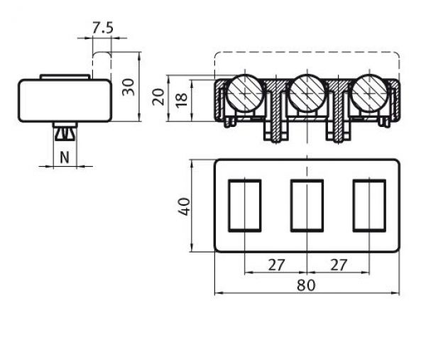

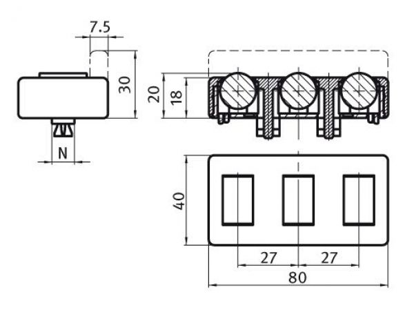

Or you can better look at them in the drawing:
I filled them with motorbike chainspray to smooth the rolls inside.
