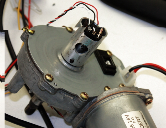

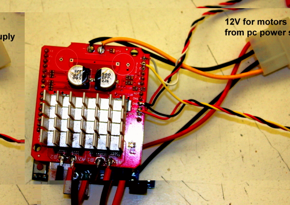

this is my motor and arduino
one motor (left) is with white cable and the right is with the yellow
try to move them with the hiper terminal
from properties of my computer see what com is the arduino and set the hiper termila to 115000
then sent R54L56 this will move both motor
the R7FL7F wise set the motors at the midlle

the photo above with the red pcb is mine "monster driver"
