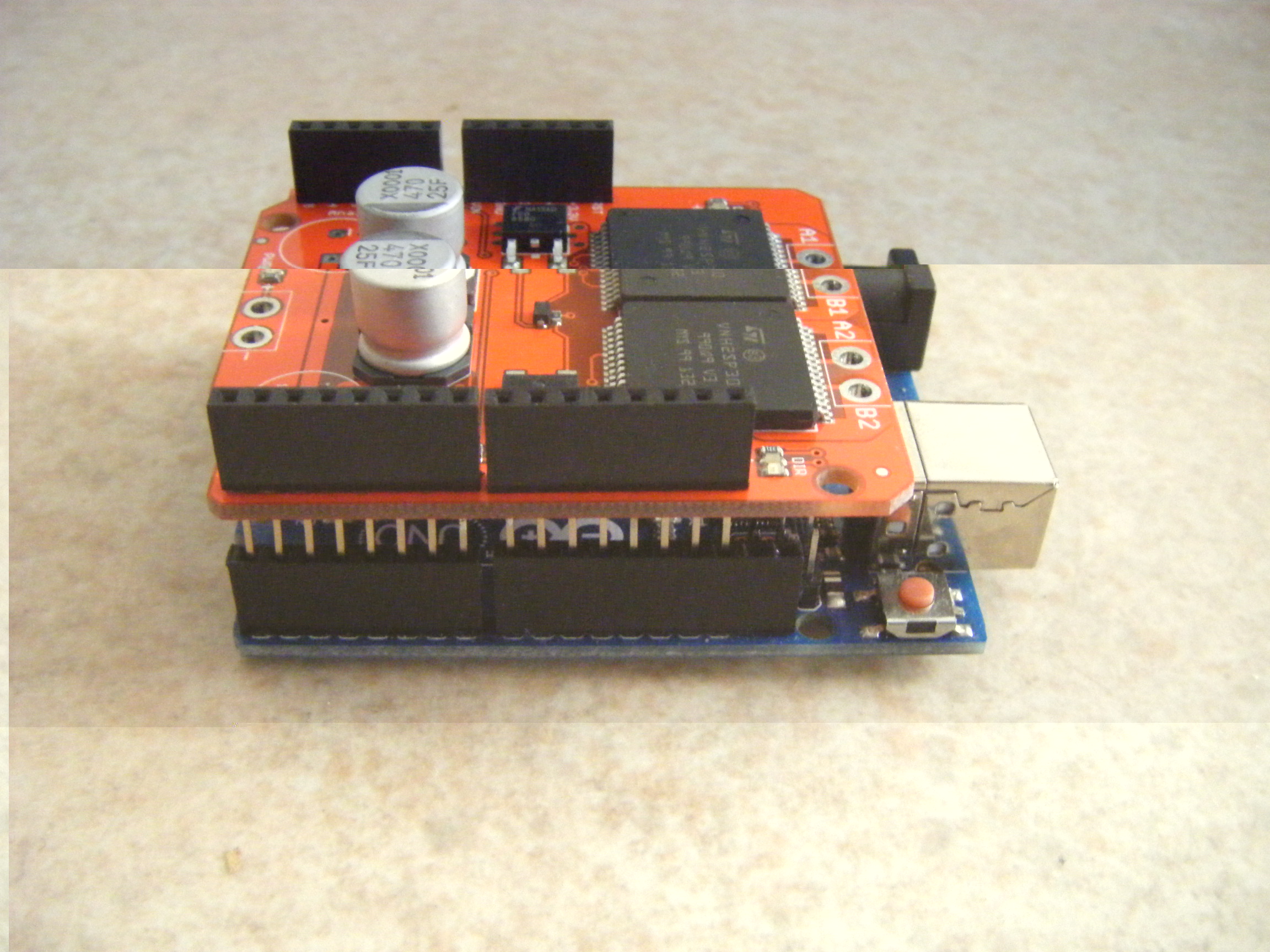

Postby RacingMat » Sun 15. Sep 2013, 10:48
Hello Aboodix5,
If you bought the Motomonster board, the simpliest is to stack it onto Arduino !
If you don't, you have to follow the following pinout :
Arduino and Motomonster have same pin's number !
connect together
Arduino .../...Motomonster
......GND <-> GND pin
........5V <-> 5V
.....pin 4 <-> pin 4
.....pin 5 <-> pin 5
.....pin 6 <-> pin 6
.....pin 7 <-> pin 7
.....pin 8 <-> pin 8
.....pin 9 <-> pin 9
pin 13 is not needed
In the initial post, I've soldered more wires but they are unused wire...
On Arduino pin A4 and A5 connect Pot left and Pot Rigth.
Mat

Postby RacingMat » Sun 15. Sep 2013, 12:20
No...
the wire should connect the Arduino's pin 4 to the Motomonster's pin 4
and so on !
Just like if it would be stacked ;)

Postby RacingMat » Mon 16. Sep 2013, 21:59
Hello mleunam !
In my configuration, the potentiometer's values are "read" by the Analog pins of Arduino .
So, there is no need to connect Anolog pins between Arduino and Motomonster.
Motomonster is an H-bridge without feedback loop capabilities : it doesn't have analog pins.
Arduino tells to motomonster information as "this way" and at "this speed".
This requires only 2 pins for direction and 1 pin for speed per motor : (2+1) x 2 = 6 wires and 5V and GND.
