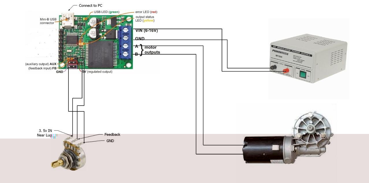

if you are running 12v motors, have you considered the JRKS?
They will handle 30 amps continuous at 12v easy.

Question;
Do I plug the JRK straight to the pc via usb without the need of the k8055 or any other controller?
Do I need 2 JRKS ( one for each axis)?
If 2 JRKs are needed how would they be connected to the PC?
Is there a Diagram from a complete sim with this configuration?
Many Thanks in advance!
Xtech007

JRKS plug in via a usb cable, nothing else, they are contoller and h-bridge in one. No K8055 or anything else needed
1 JRK per motor/axis
JRKS use the utility program to set up some basic PID, feedback and some other functions.
The plug in is for the JRKS to run in x-sim
Depending on what 12v motor you use, we can recommend some basic PID settings to get you moving.
Not really a diagram, apart from the pic for wiring them up, obviously the pot needs to be moved by the motor.
To connect see photo.
Hope this helps a bit.
Yes I know we need a proper JRK thread.
heres a pic showing a pot setup on some motors using single turn pots
Cheers, David.
