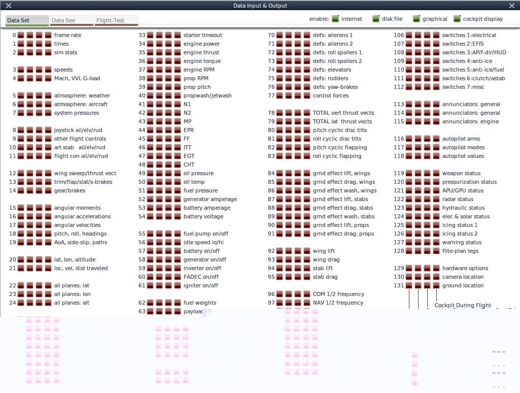

Ok, so here is X-plane 9's data sending checkboxes screen:
X-plane 9 "Data Input & Output" screen

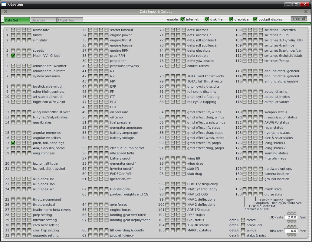

and the very same screen from X-plane 10:
X-plane 10 "Data Input & Output" screen
As you can see here, they have changed "Pitch, Roll, Headings" data from the former number 18 to number 17 in version 10.
You have mentioned number 16, but it was "Angular accelerations" in version 9 and now they call it "Angular moments" in version 10. As far as I understand we'll need Pitch, Roll and Yaw POSITIONS instead of angular velocity/moment data.

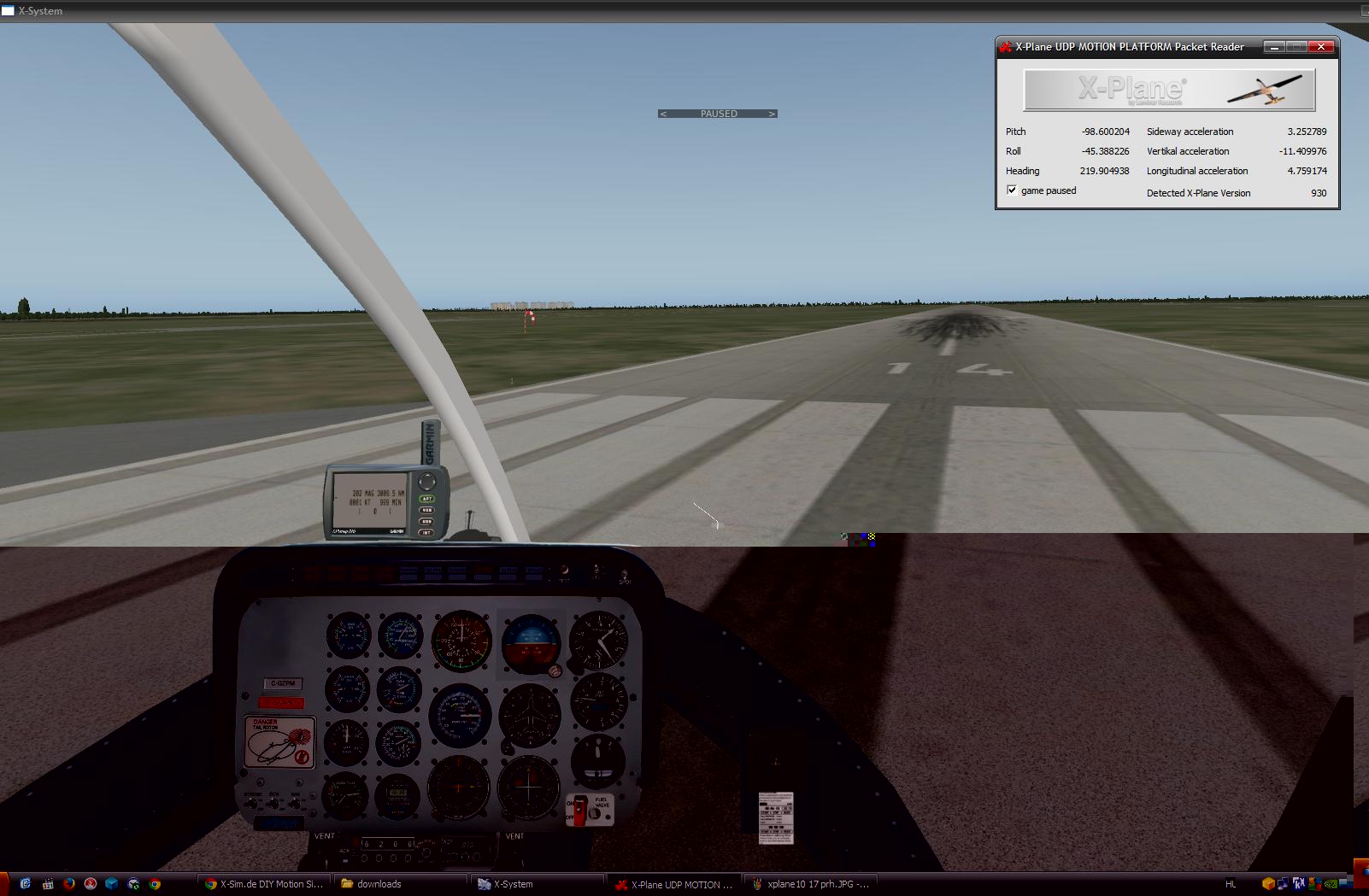

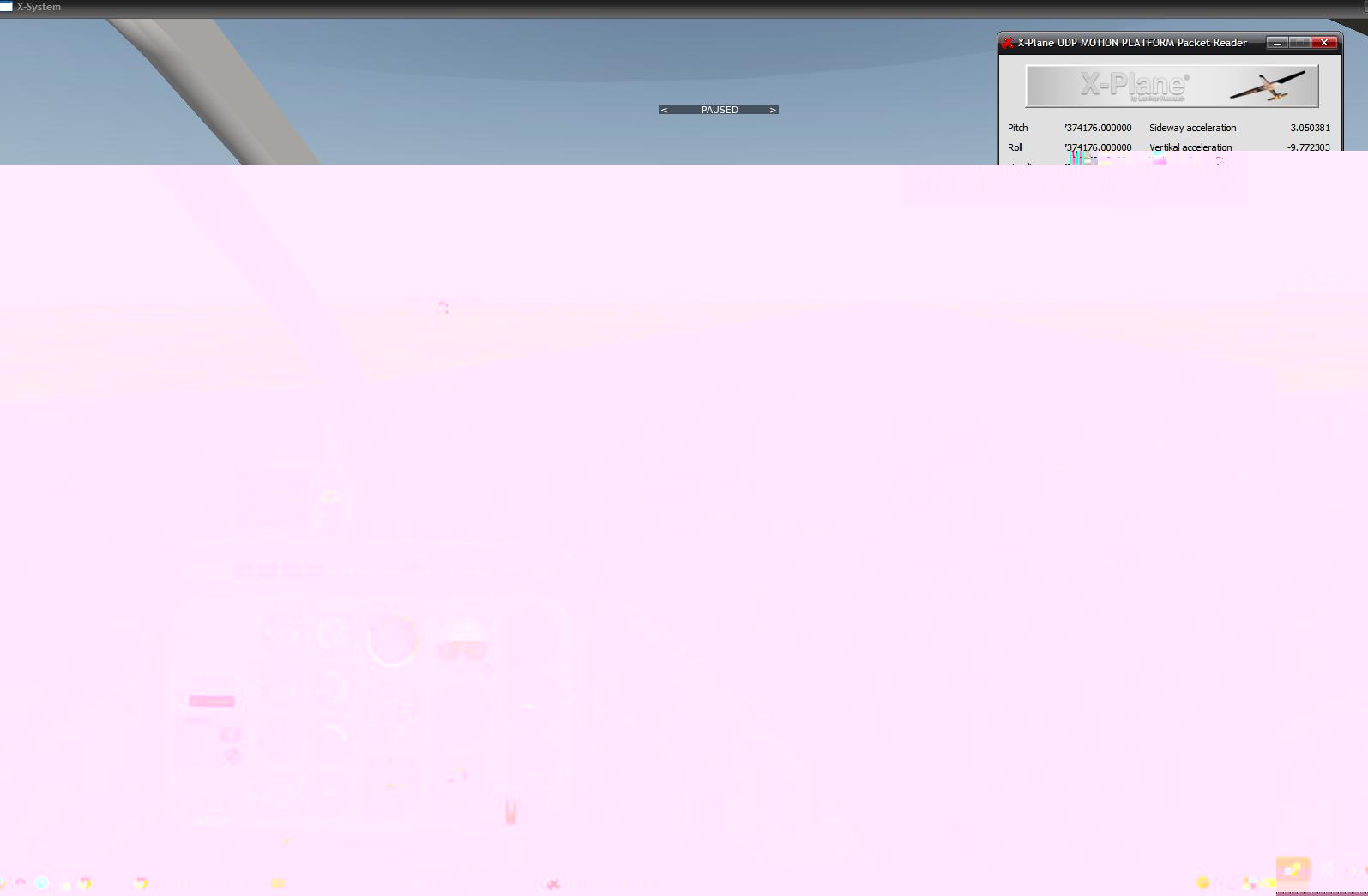

I've downloaded the attached "X-plane.exe" file and I made two screenshots:
I've checked checkbox no.17 (pitch, roll, headings) at this one:
And with checkbox no.18 ("Pitch, Roll, Headings" in earlier versions but "AoA, Side-slip, Paths" in X-plane 10)
I also have noticed that it says "930" for "Detected X-plane version", but it is X-plane 10.
