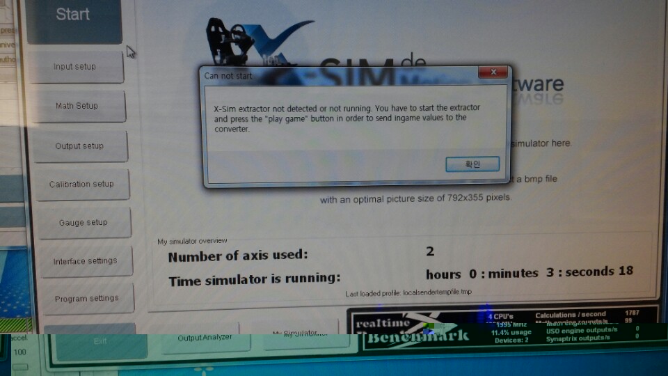

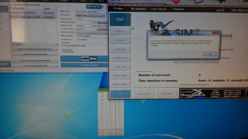

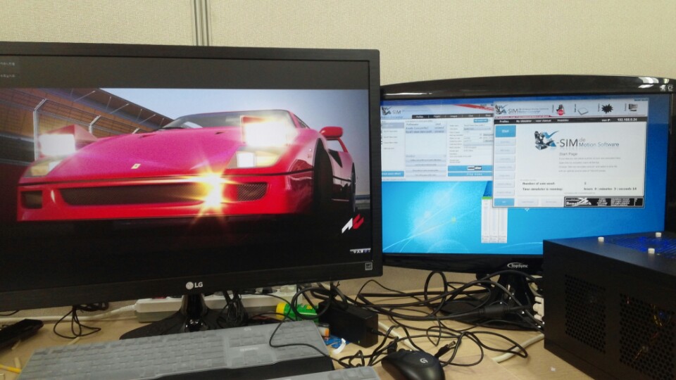

I use the x-sim free version software and 1 hours ago,I buy the game assetto corsa through steam.
I made the profile using converter( G27 logitec, SCN5 actuator). However, when I click the "Play game "in Extractor and
click the "Start" in converter,the converter is not working. However, the actuator was working and the result value in
math setup was moving when I test the game race 07 demo.
WHAT'S THE PROBLEM?
Should I donate money to get dongle key? If I should do that, what kind of version should I buy?
I am really wonder!!!
please teach me how to solve this problem~~
P.S) I am Korean so I am not good at English. Please understand my write.
that pictures are my current situation~ HELP ME!!
