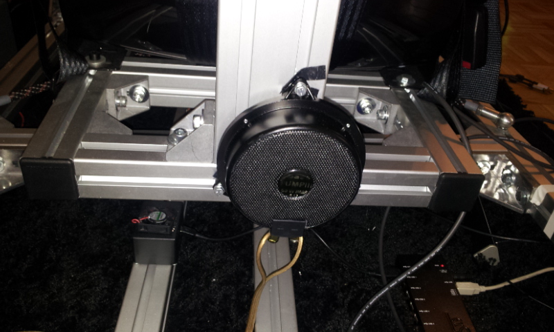

I have to wait (still) for the ordered shakers. But for testing I ordered a single cheap available shaker on ebay.
Sinuslive Basspump 3 mounted to seat-rig:

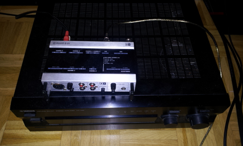

The shaker is attached to an old Yamaha amplifier which can handle 2-16ohm in a realistic range of 100w (a bit overpowered for the shaker). The amp is connected to an Native Instruments Usb Sound Card:
