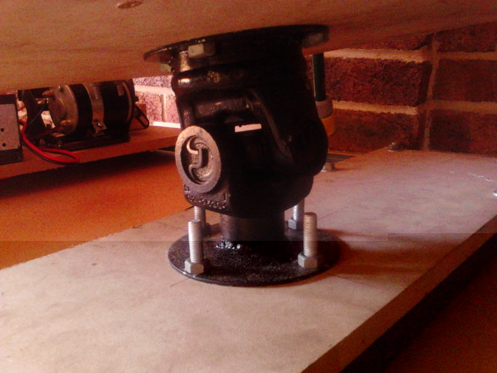

A base (have a simple one in mind with metal rods attached to back of seat)
A u joint for seat (from a car drive shaft I think??????)

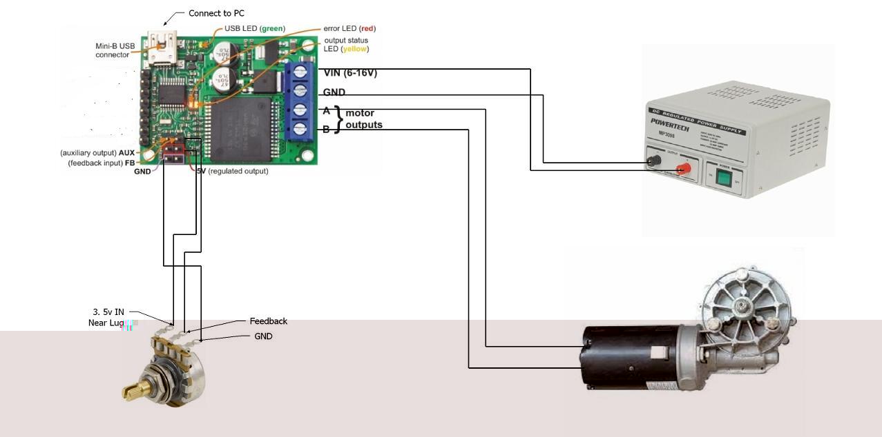

Wiper motor, make sure they are earth isolated from their own casing, otherwise you will get voltage feedback and blow the JRKS and or your PC.

I have added a diagram to find the earth (thanks bob).
And also a diagram to hook up the JRKS to motors, pots, etc. JRK link http://www.pololu.com/catalog/product/1393 , put a heatsink on thebig chip and a fan on it, they will handle 30 amps continuous.
The idea of a pot is to give a feedback signal to "tell" the motors where to go next.
it s a matter of making a lever for the pot to stick to and then feeding that lever onto the motor lever.
A cut down tailshaft is ideal for pivot point. Just a matter of getting the frame balanced right.

I noticed in the diagrams u posted there are dc power supplies.
Do I need 1 for each motor or will 1 do both and any particular type of power supply?

For power supply, either use a car battery of 330cca with a 20 amp 12v power supply in parallel for both motors , or one minimum 40 amp power supply per motor at 12v to 14v. So you need 2. Just dig through ebay for something. I use both options as I have 2 sims currently. Both work just as well. Car battery setup was cheaper , but heavier to drag around.

Then again, the design was based on 25mm x 25mm x 1.6mm steel box with MDF sheet on the bottom of the seat as a base for the unit pivot point.
I used different motors than what is pictured for this one I built a while ago. But big worm gear motor would really kick.

I like that last pic u posted was what I kind of what I had in mind :)
