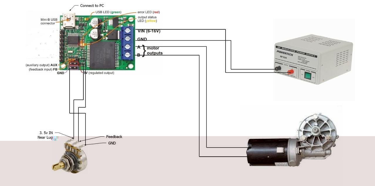

Can someone explain to me what is purpose of using the pots for motor feedback position? Do I have to do that with Pololu JRk 12v12

Postby motiondave » Thu 3. Jan 2013, 02:07
The pot "tells" the motor where to go next via the control board.
Yes you need to hook up a pot on a lever of some sort to the motor shaft or motor lever. Use a single turn linear 4.7 or 5 kohm pot.
viewtopic.php?f=37&t=159 link to past projects.
Once you have sorted the pots, then you can move up to multiturns if you like with gears.
Image I used left over metal gears I had lying around.
I am also using second hand actuators I had to fit new motors to and do something creative with the feedback pot.
also , heres a wiring description diagram for the jrk. Yes you need to set the pot up onto the motor/

thanks for the pics very helpful! those last 2 attachments the one with the wiring i can't seem to click to make big it just says "loading" is there any other way to view it? Thanks!

Postby motiondave » Thu 3. Jan 2013, 14:19
works here, but I will upload anyway.
Image Image
