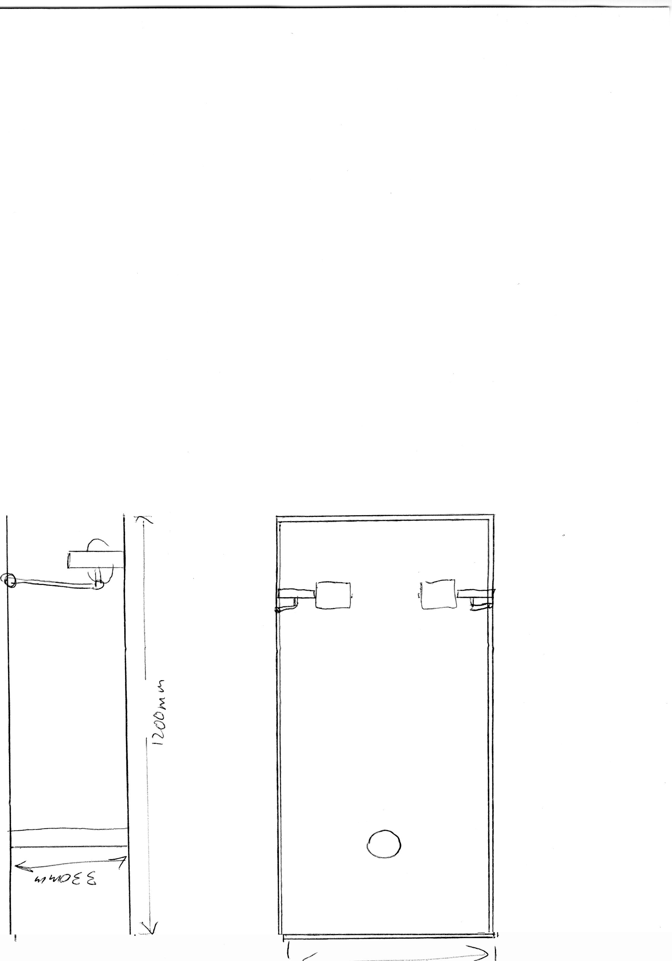

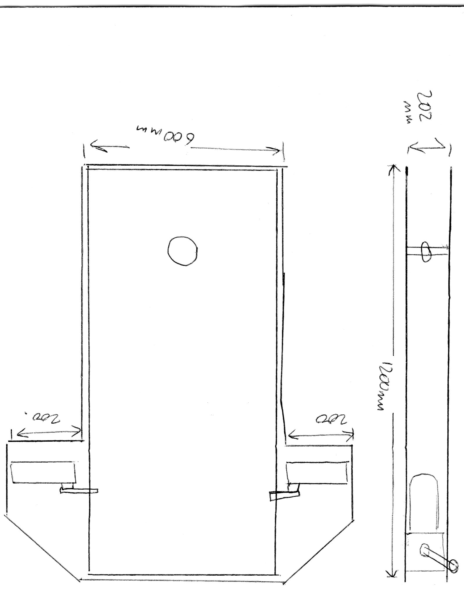

Postby motiondave » Sun 23. Dec 2012, 10:04
Wiper motors you need to earth isolate the bodies , otherwise you will blow jrks.
Wiper motors, nothing special, just maybe from a large passenger car.
Wipers can start you.
Maybe a big MDF base underneath, and put motors at front, like in the sketches.
