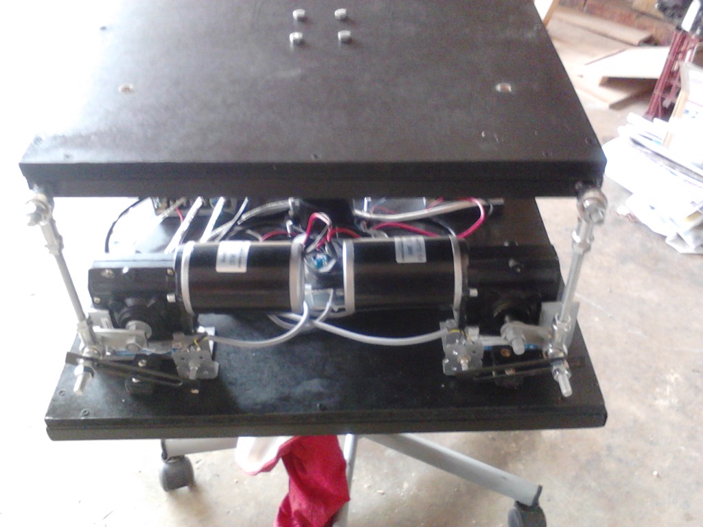

I have added a general sketch of a seat mover, which is what you have planned.
This was designed with 25mmx x 25mm x 1.6mm steel and 16mm MDF sheet wood.

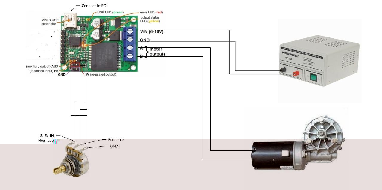

Also is a pic of how to wire up the jrk ,and an example photo of how the pots connect the the levers for feedback.
