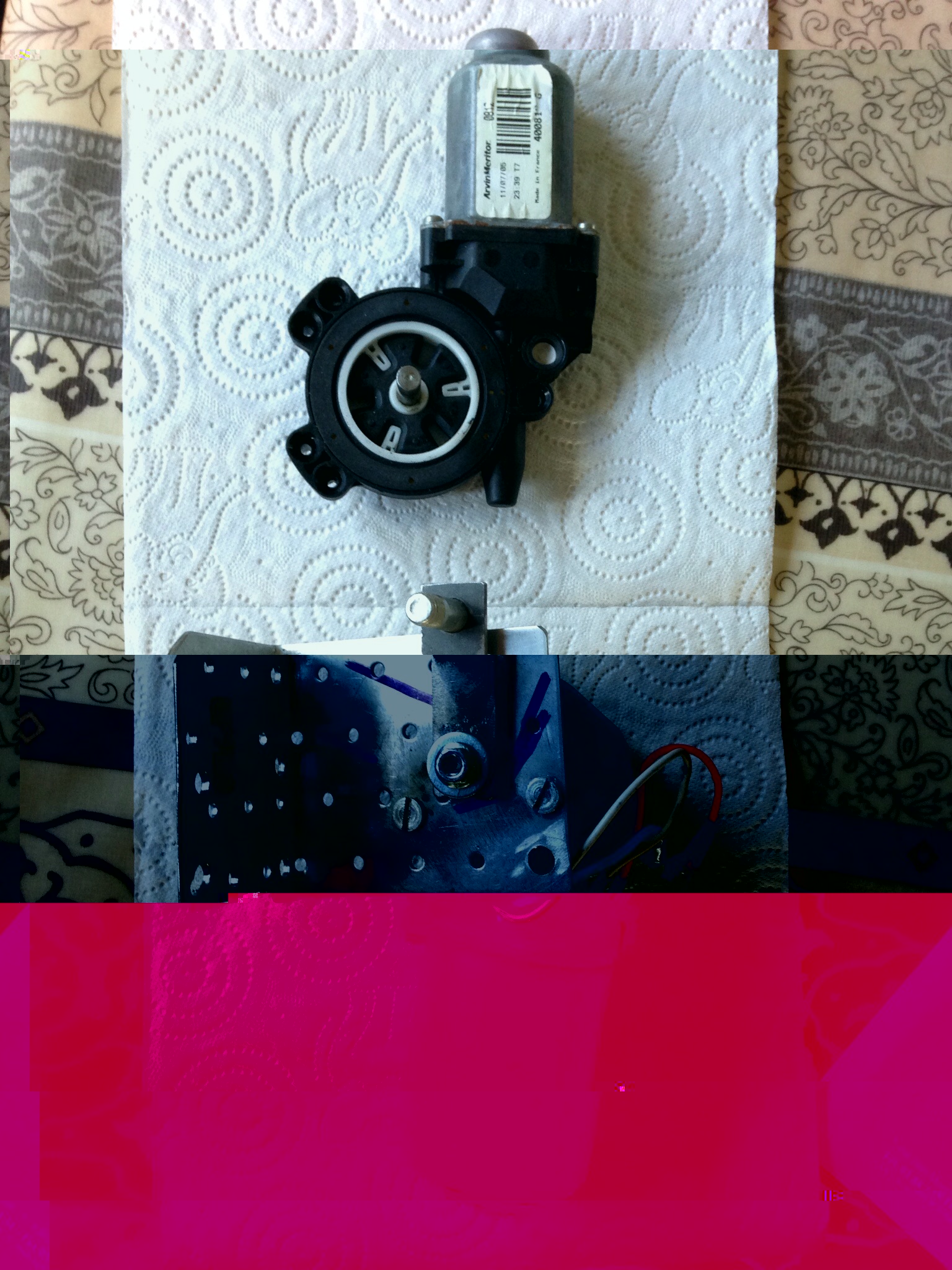

Re: Please help me planning my G-seat
Postby vicpopo » Sat 9. Nov 2013, 13:27
Hi ,
A pic from both motors !
Motors
I don't know how the car lift window powerfull is . :shock:
