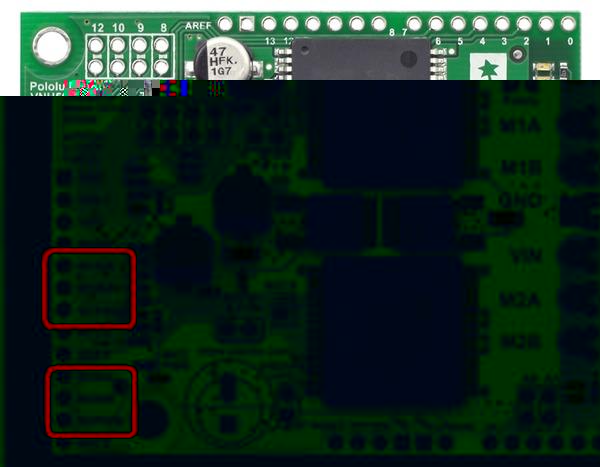

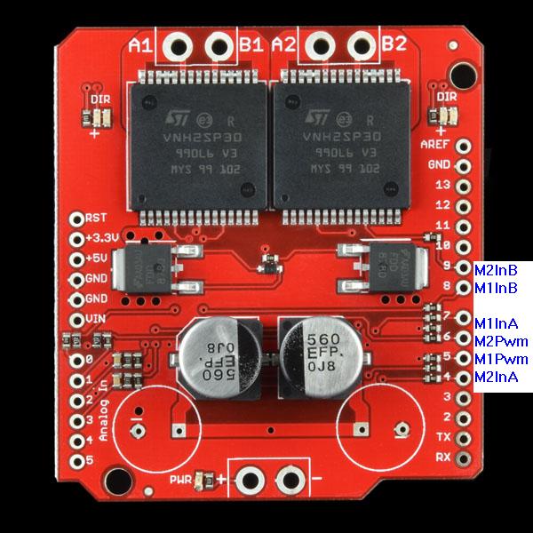

The pololu HBridge you ordered is similar to motomonster board : it's a 2 pins direction and 1 pin pwm board.
Pololu dual VNH5019
Motomonster Sparkfun
