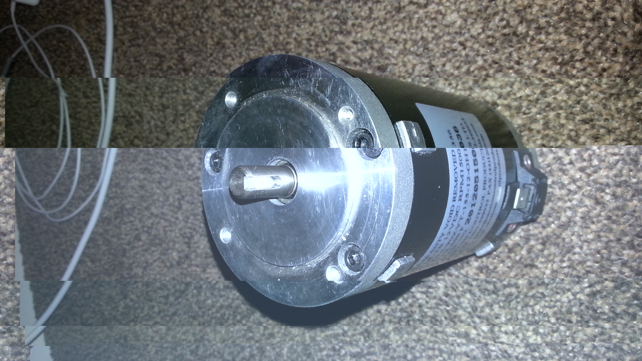

Postby GhostNI » Tue 20. Aug 2013, 01:07
Need help with gearboxes.
I read b4 on prodigys rig thread that the 90zyt-155-12 motors fit the MCP4 gearboxes but looking at the pic it doesnt look like they match up.
http://pages.ebay.com/link/?nav=item.vi ... 0751091855
3rd pic on listing is what im worried about.
GhostNI
Posts: 23
Joined: Thu 11. Apr 2013, 20:41
Location: Belfast Northern Ireland
Re: another new guy
Postby yokoyoko » Tue 20. Aug 2013, 12:29
http://www.motioncontrolproducts.com/pdfs/pmdc_2.pdf
If you are not sure perhaps ask the guys from motioncontrolproducts? As I know the mcp4 fits for the zyt-90 and the mcp-2 for the zyt-80.
