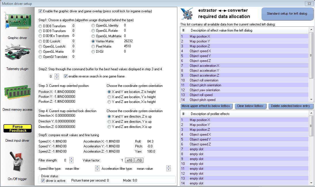

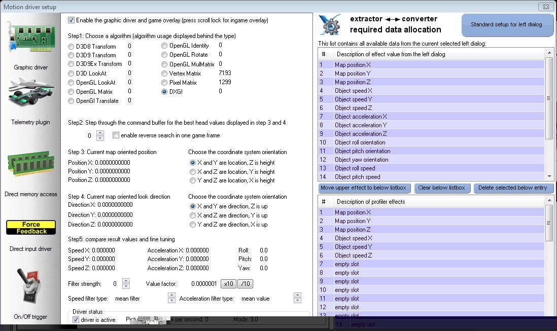

I tryed all DX algorithms available. Here I attached some pictures from the GD.

Dou you use the ingame overlay display or do you switch with alt/tab?

I tryed to use the overlay but did not work for me. I will try a little more.
Anyway the game crashes even if I do not alt tab. I set everything up before by * the profile and click to "play game" and it chrashes when it gets to the cockpit. I also tryed to run the game in standard and dx11 modes.

This is very interesting. The framesrate is available while it freezes. Can you provide the game download?
The graphic driver will be the focus of the next year. Not all algorithms are included for now and they will be added step by step acording to the delivered not working games.
The stable algorithms are all exept the last three ones. This are pixel shader solutions and you know this is handled in the graphic card hardware.
