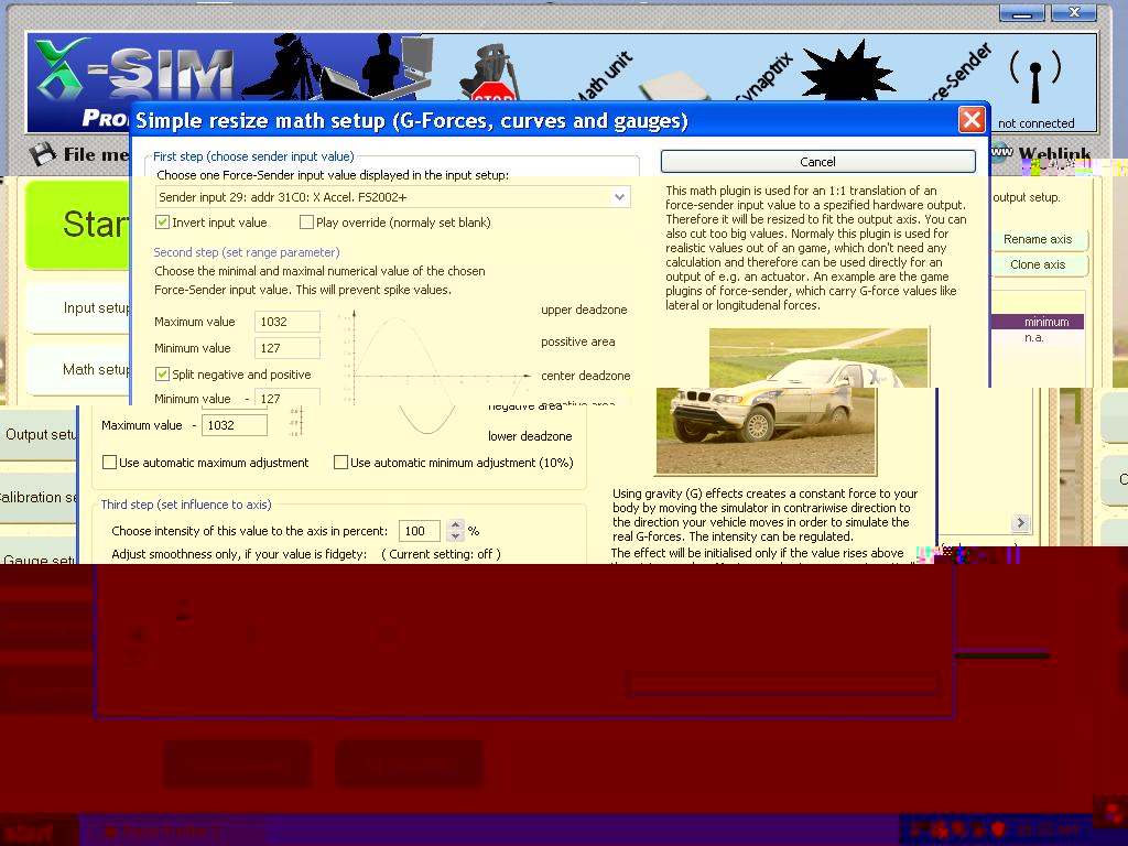

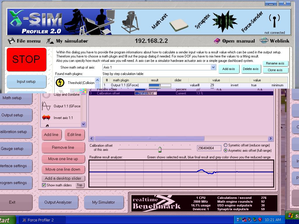

I've been building a JOYRIDER type of simultator with two wheelchair motors for propulsion, and a AVR 1.5 and 2 Pololu high-power motor drivers 24V20 to power them. Also I've been using Flight Simulator 2004 to get started. Right now, I've been working on the X axis. The problem is, that when I do a two minute turn, lets say to the left, half way through the turn the simulator changes 180 degrees and does a flip flop to the right, the same thing occurs to the right hand turn. I've done a number of things to try to remedy the situation...to no avail. What do you suggset? :?: Any help is appreciated.

I think I have resolved the situation (thanks to Nima). I scanned the table of all exportable elements and found an obscure input called 057C /Bank /var.Type S32 , it seems to do the trick. I wonder why that was not listed on the EFFECTS page on the Pete Dawson's FS Modules page, that would be the first item I would place on the page followed by pitch. But who am I, to question such things. Once again thank you NIMA!!!!
