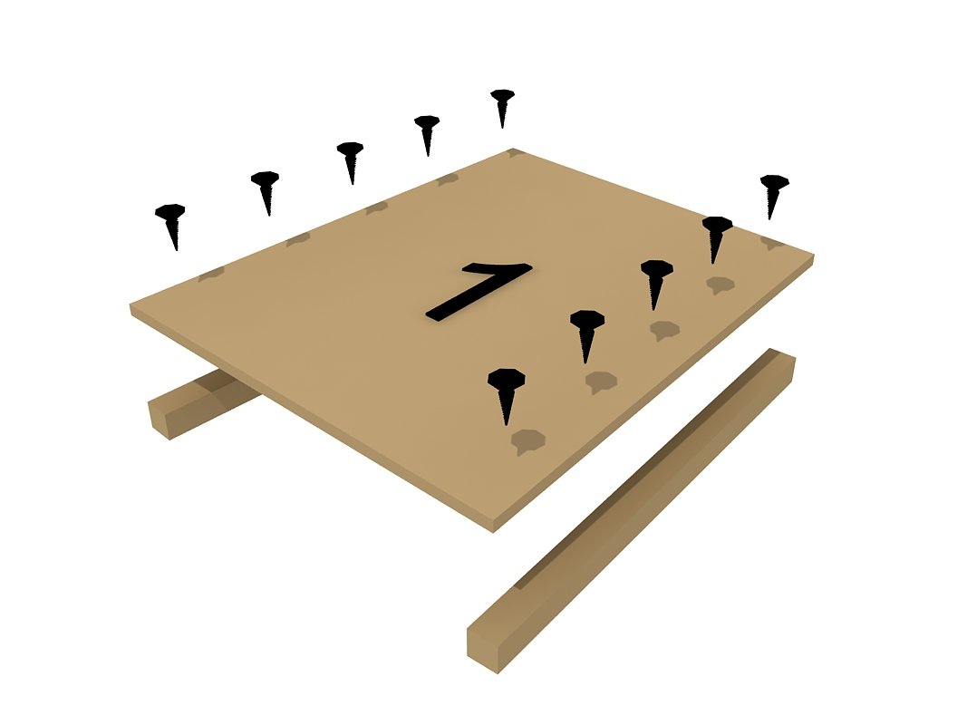

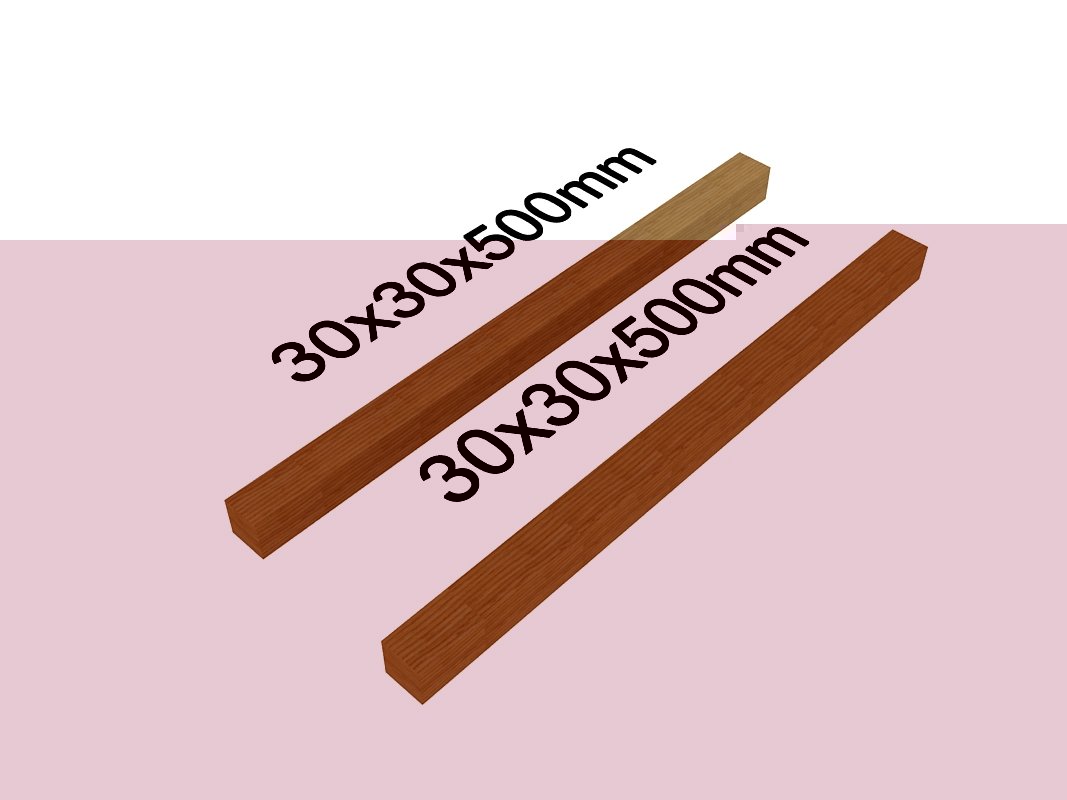

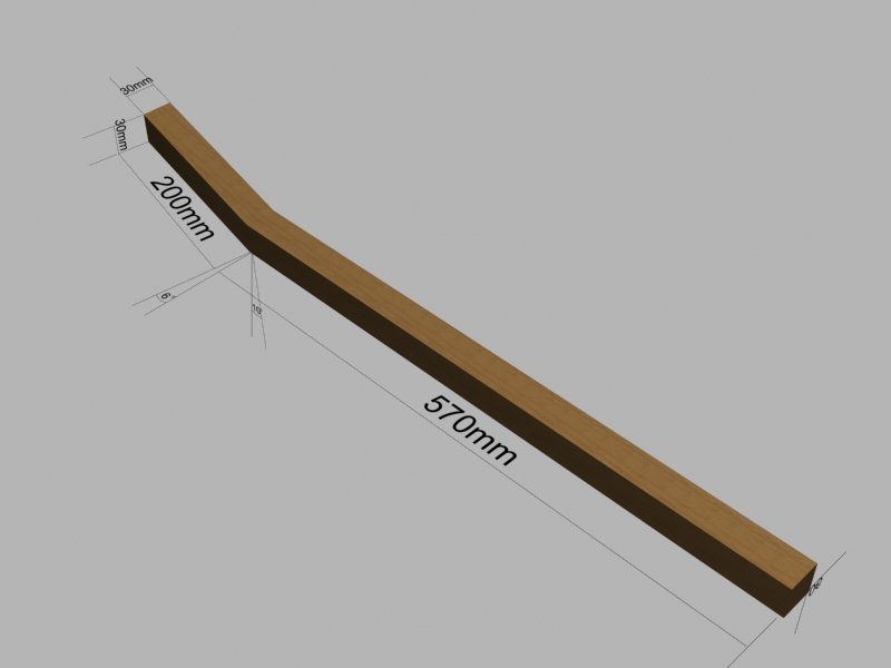

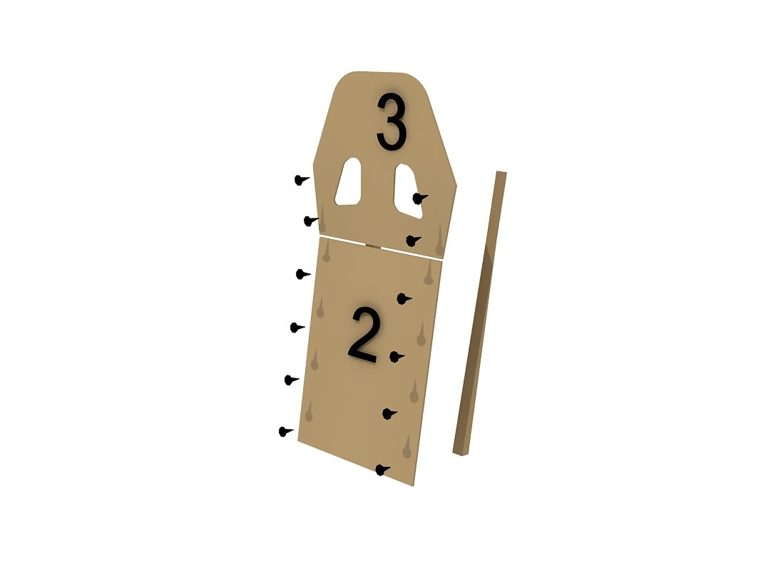

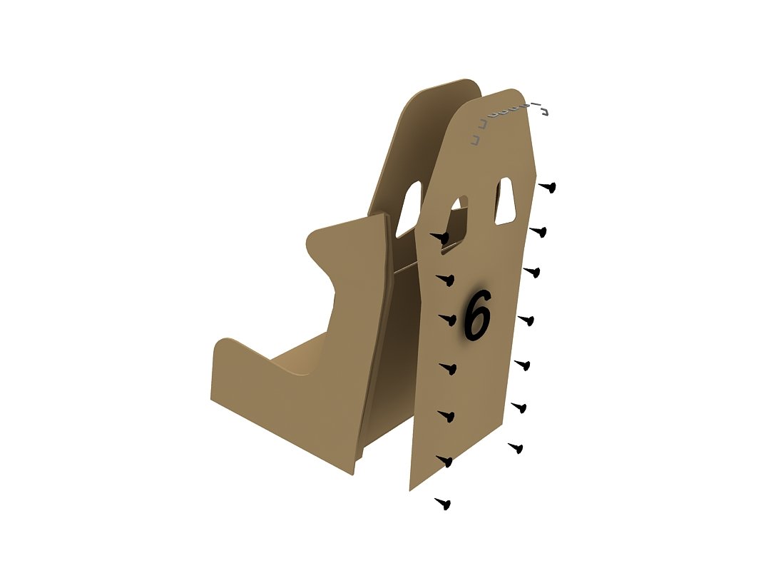

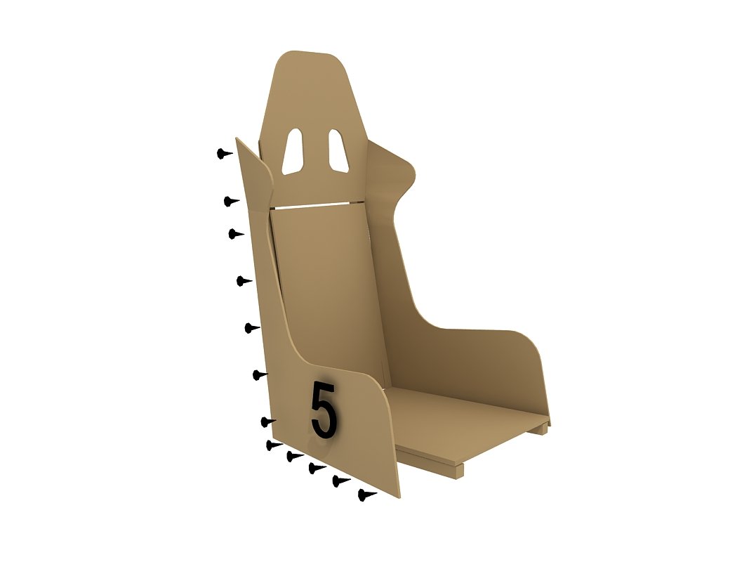

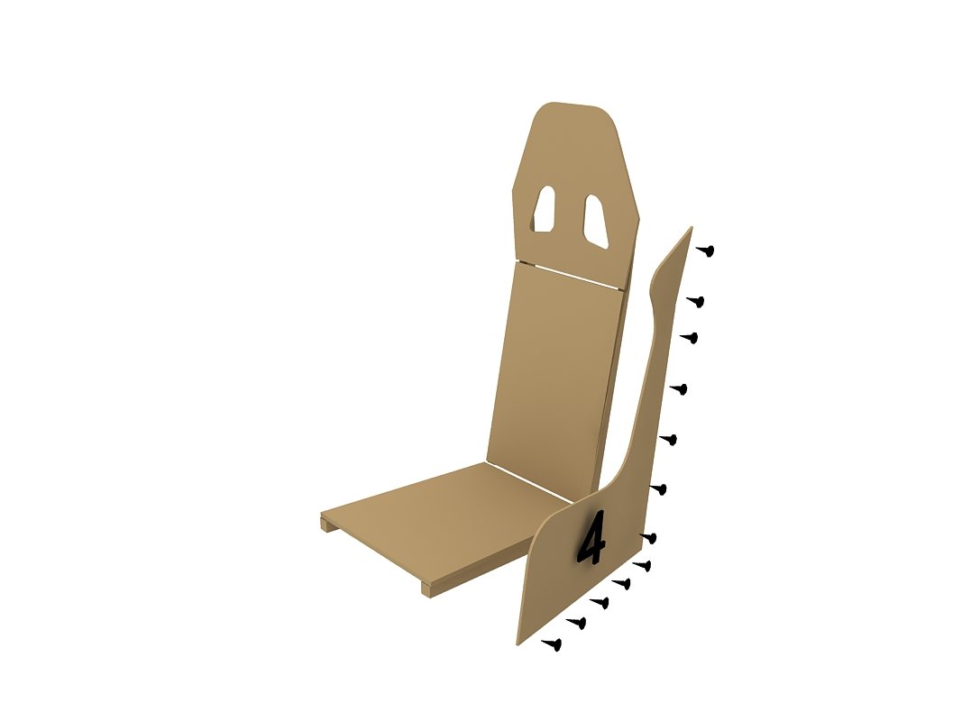

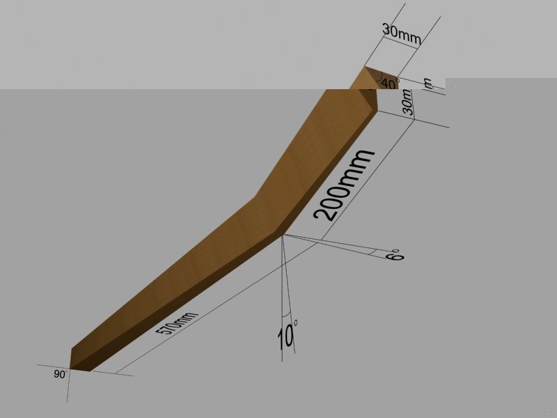

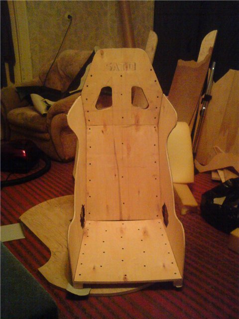

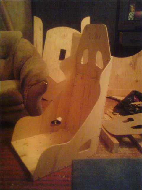

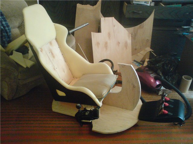

Postby motiondave » Mon 25. Feb 2013, 13:43
wooden racing seat or wooden frame?
the wooden racing seat was made by a bloke on the other forum.
found some pics

Thanks motiondave,
That's exactly what I was after.
Much appreciated.
