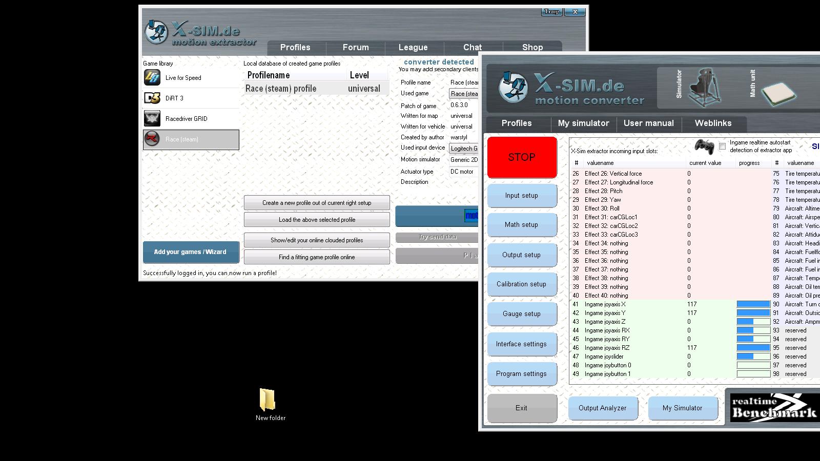

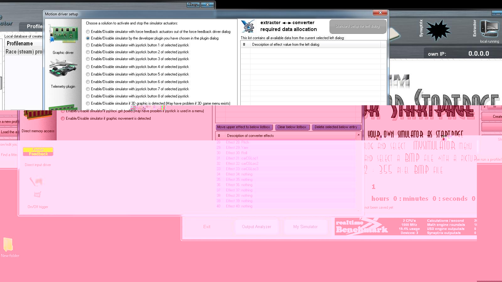

I have an idea what could be the prob...
please have a look:
in the extractor you choose your game "Racedriver Grid". You have to confirm both following messages with "Ja".
After this a new window will appear. Here make sure that the "effects" are placed in the "lower box" - otherwise you send no info's on effects to the convertor.
edit: don't worry about "Race07" I took this screenshot of the manual. (not at home for a real screenshot)

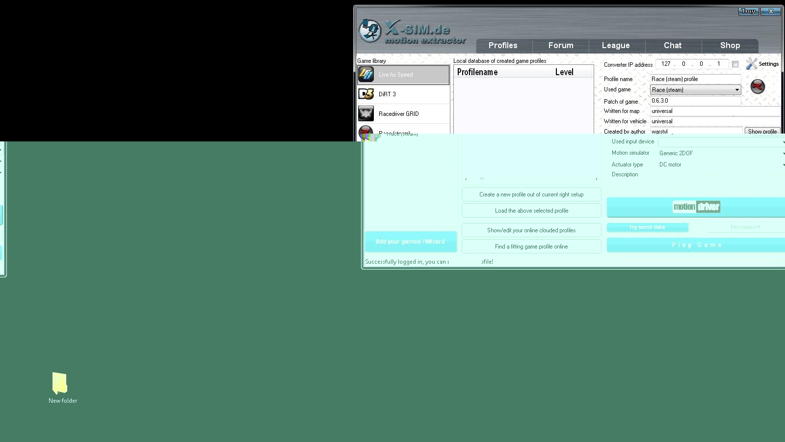

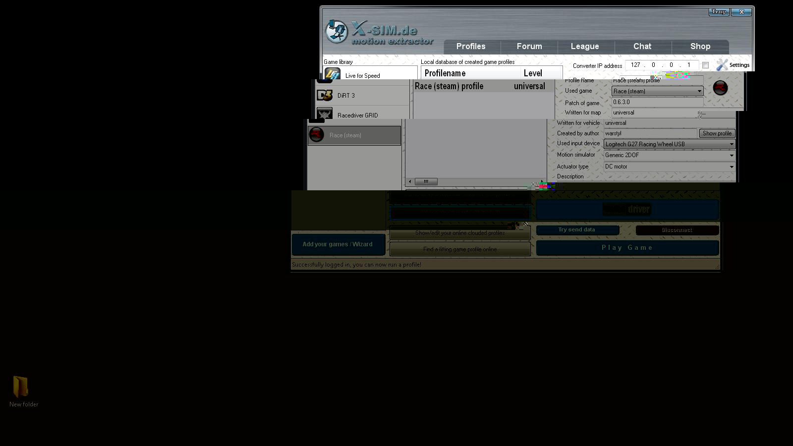

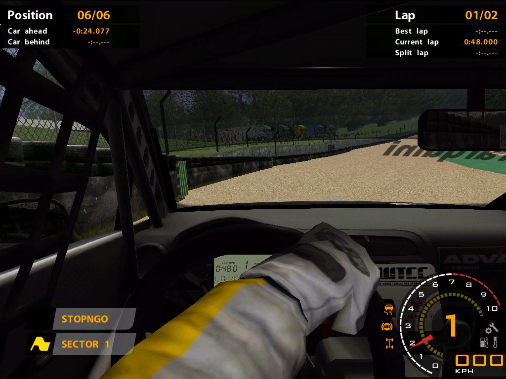

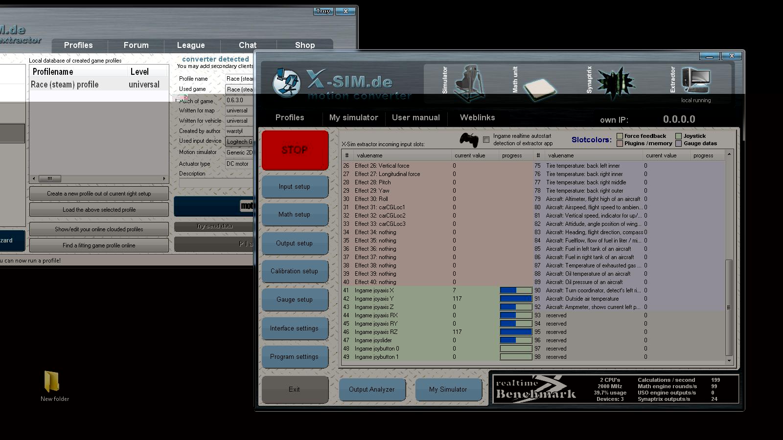

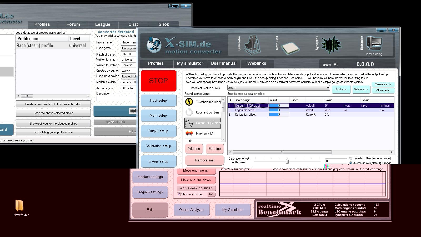

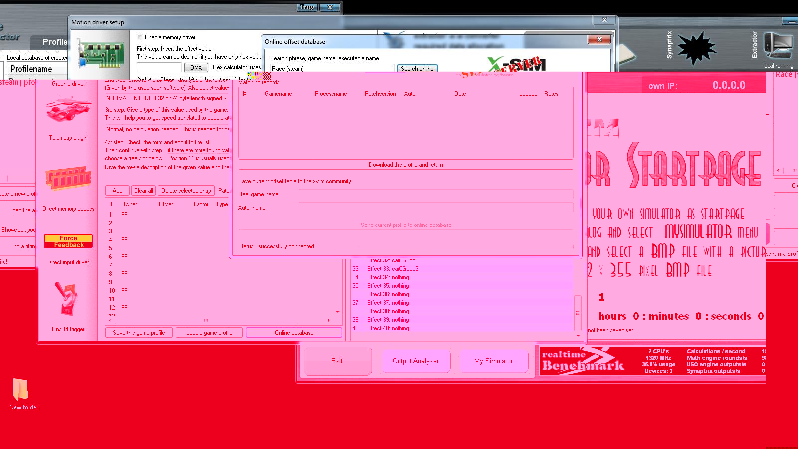

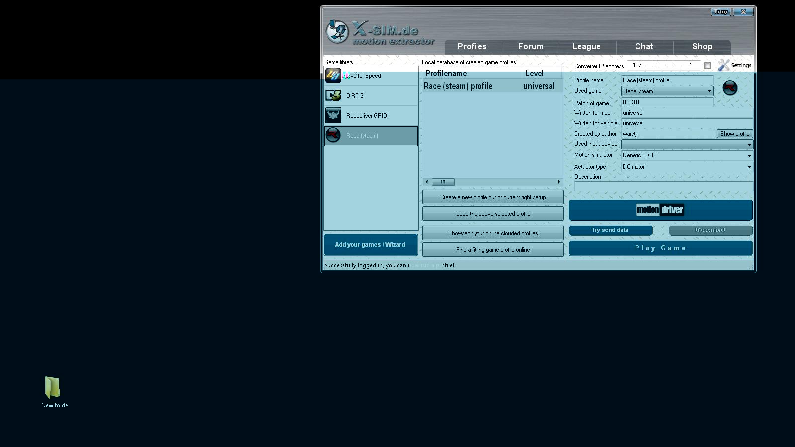

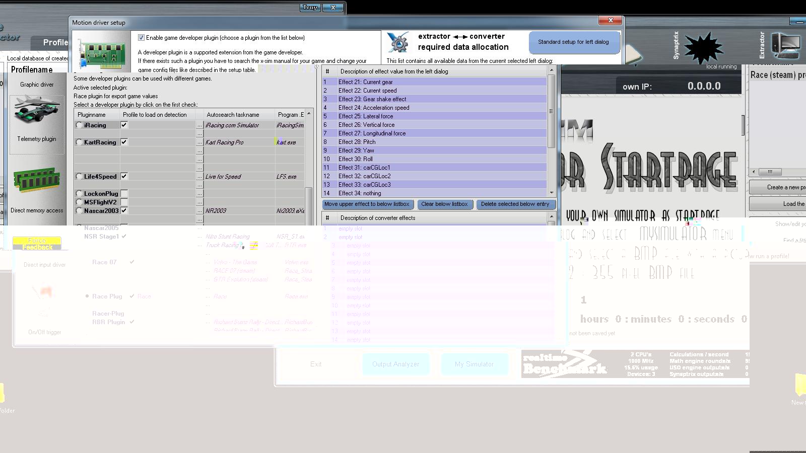

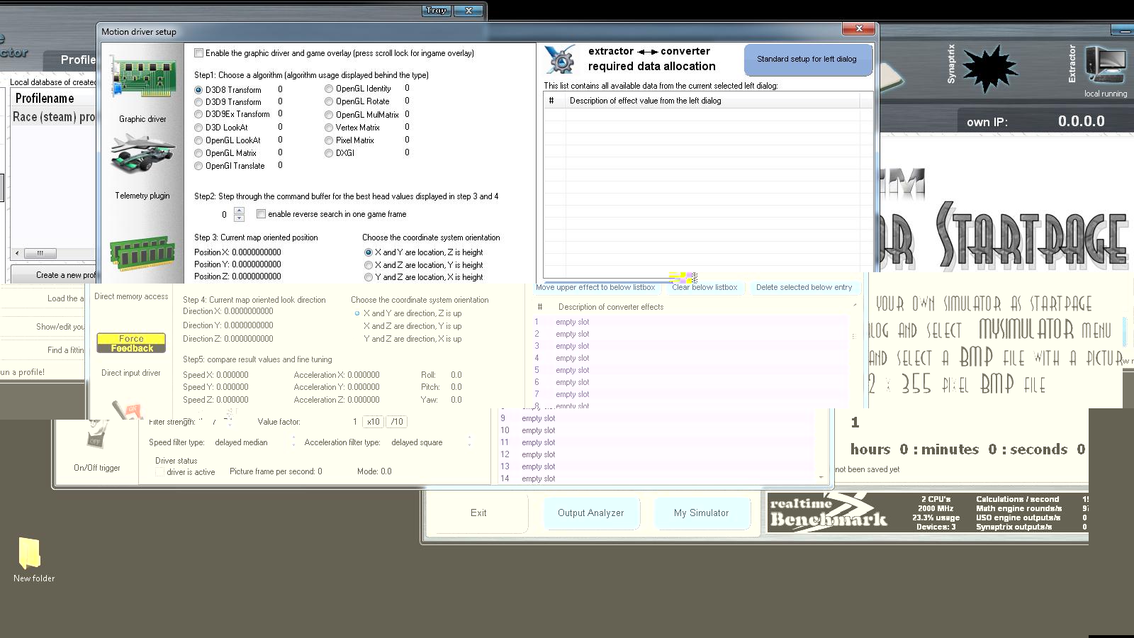

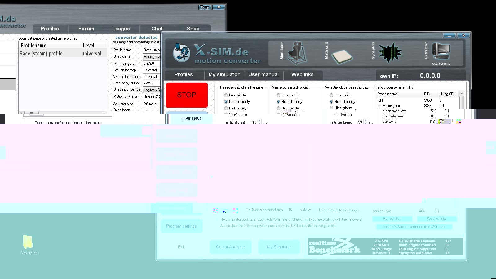

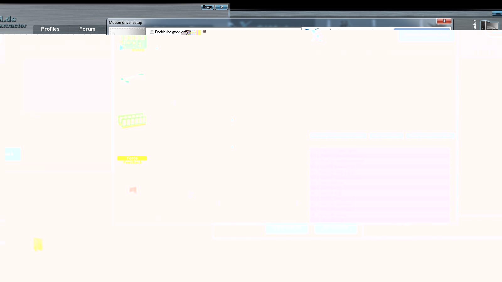

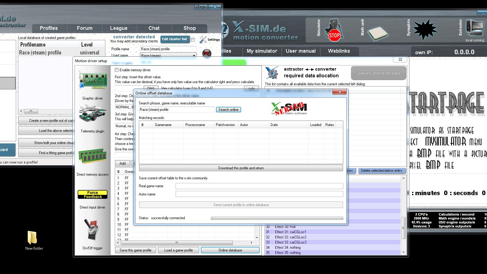

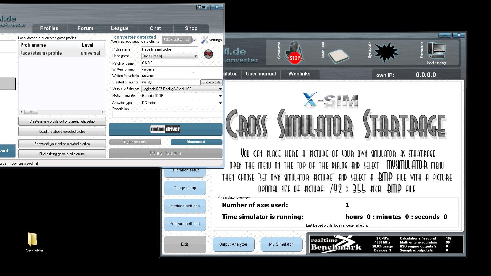

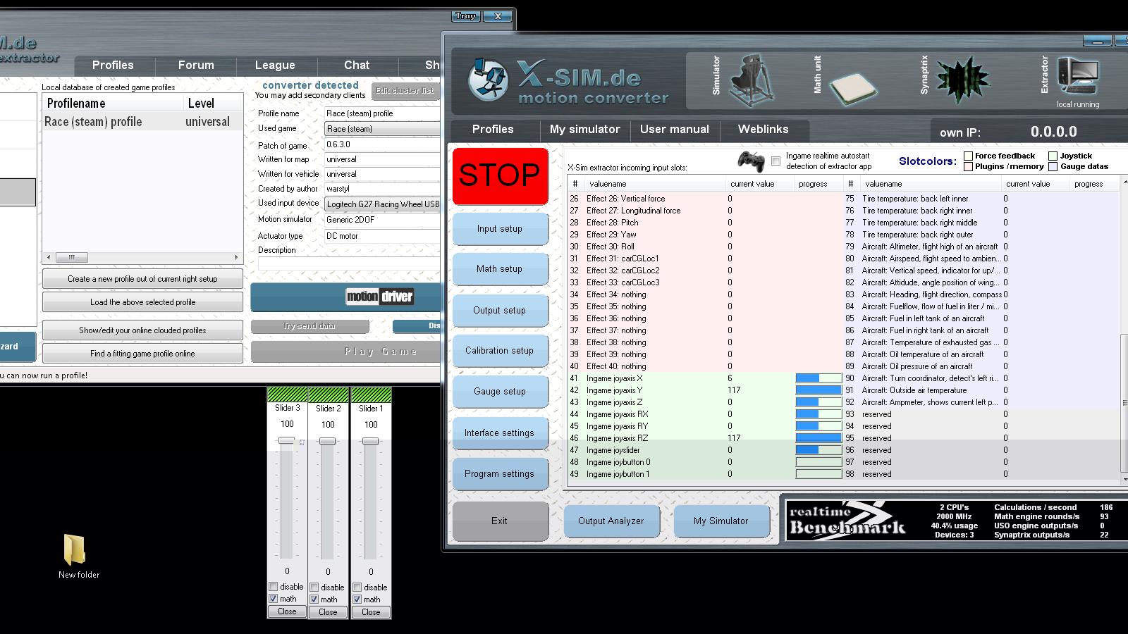

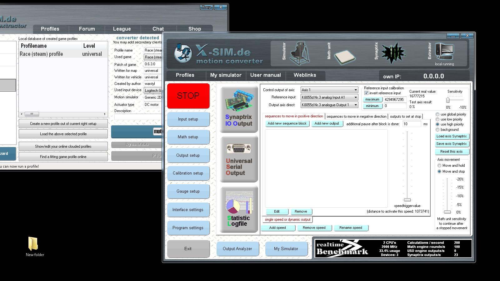

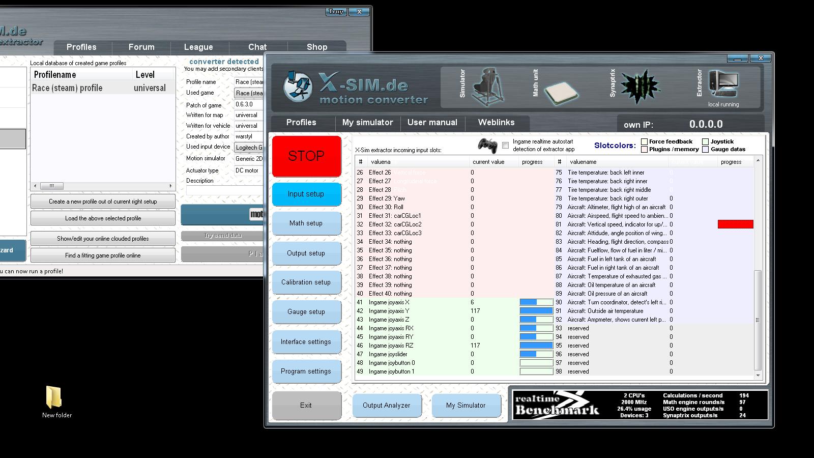

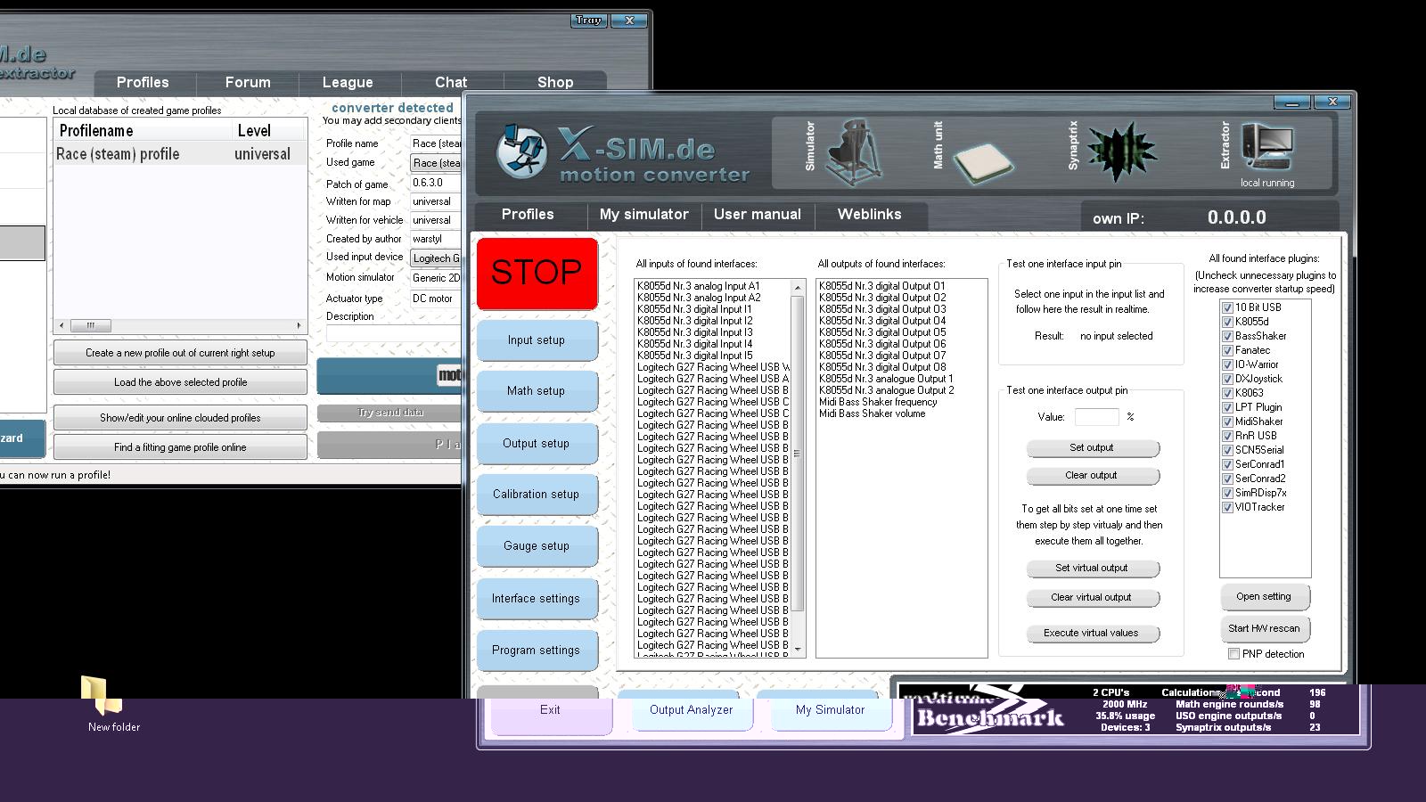

Please forgive my total ignorance .Although I am very technical,computer and technical skilled I think I am either overlooking something or my setup is not correct somewhere .You will see I have used two small dc motors and two potentiometers to simulate feedback as I know if I use the simulator motors with the potentiometers coupled I am going to destroy the system which I do not want to do ,hence the preference of using the motors and pots for testing.The motors just keep on turning and it does not matter whether you run the game and look at the profiles ( I have now set up dual screens ) the values do not change driving and then controlling the pots .Yesterday I had some values in the upper section which you refered me to see that they change .There were values there but nothing changed .I think this is a profile problem .??/ I cannot recollect what I done as I chnged a profile selection and the values were there and then I chnged it again and then there was nothing .Unfortunately it was one of those situations where one does something while testing and then forgets what you just had done Ha Ha age !!
I have taken a lot of screenshots so I will just send them through a few at a time ( sorry about that ) so that you can see what is happening.The shots are basicaly in order .I have also sent some photo`s .The velleman board has full control if you type the output values eg analog output no1 /2 in the one screen and select a value eg:50% etc .The motors then stop ,slow down or change direction based on what you type in and the potentiometers show that they are working if you select eg: analog input 1/2 they show that they are changing values in the one screen.
You will also see the profiles I have searched and xsim has put in for me .However some things there do not appear to look right.
On screenhot 3 -is the input device selected correct ?screenshot 4 gives me no change at all with anything.
Screenshot 5 I have decided to run Race on its own .As you can see the slection .Is this correct?The startup does does take so long to load but the results are same.Screenshot 6 as you can see there is nothing happening I can only select selection 2 it does not allow me to select any other selection.Screenshot 7 allows me to select the remote IP address but Where do I put it in??
If you look at screenshot 8 I cannot get the profile from online .I dont know if this requires stager 2 access for this.
Screenshot 9 ,still no change Screnshot 10 no change and does not allow or show me driver is active anytime when running the game or testing .Screenshots 10/11/12/13 remain the same -no change, Screenshot14 only some of the ingame joy axis change values
Screenshot 16 is the one which I am puzzled by that the profile does not appear to look correct
Screenshot 18 is the one where I type in the values and select the input and output and see the percentage and results change for the pots and motors individually .Screenshot 19 does not show me anything else .If you setup a profile you can then click on any selection and then see how it is setup .This does not allow me in this profile??? Screenshot 20 -- don`t know if this is setup correctly??
Sorry for taking your time But I am really lost and require some guidance .Thanks again

On picture 6 you didn't copy the effects from upper box to lower box like Yoko told you: "After this a new window will appear. Here make sure that the "effects" are placed in the "lower box" - otherwise you send no info's on effects to the convertor." Therefore you're not getting any data from the game, longitude force, vertical etc..
And as I see on picture 15, you didn't set minimum, maximum and stop positions for both motors, that's the problem why motor are continue to rotate continuously.
I don't even have my simulator finished yet, still waiting for parts, but I've read manuals a lot of times and there is everything pretty good explained. Just need to follow the steps..
Have you tried to connect with Yoko with TeamViewer? He could probably help you do the basic profile setup, but yet again, you will need to learn how to tweak it to suit your needs.
