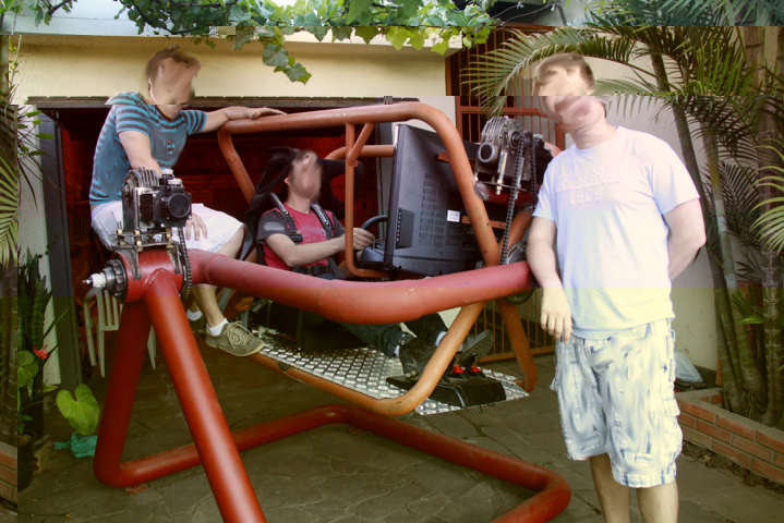

I would like to build a platform 3DOF, 2 motors for movement / 1 motor for yaw, with brushless motor
ECMA-C20604ES (400W)
Series Low Inertia Power: Nominal 400WCoppia:
NmCoppia 1.27 High: 3.82 NmVelocità Rotation nominal:
3000 rpmVelocità Rotation Maximum,
  I do not know anything about electronics I Need Much Help.
  One thing I would like to build similar
can anyone help me?

Do you have any more information about the rig in that picture (website link)? I'd like to know what motor and power supply/control they're using. Details, please, if you have them.

Postby CraCk » Sun 14. Oct 2012, 12:31
This simulator is used The motors are servo motors (1,5kw @ 2500 RPM !), with a gear reduction of about 90:1. The electronics are the servo drivers and a msp430 microcontroller.
http://www.*/forum/360-sim ... lit=Motion

Postby Turn » Sun 14. Oct 2012, 15:44
Thanks, crack. Yes, I found the original announcement post here:
http://www.*.de/forum/presenting-free-roll-free-pitch-simulator-t2786.html
user gsffair stated they used an 1.5 kW AC servo motor from here: http://hzmgdj.en.alibaba.com/
I think their project may have turned into "BS Motion" after that.
