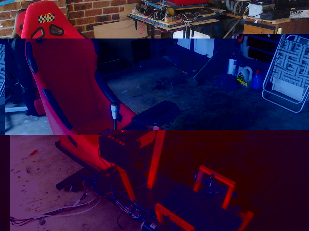

Postby motiondave » Sat 4. Aug 2012, 04:19
So what sort of frame did you want then?
Are you going to put an existing frame on something for movements? Like a playseat on a pivot, wheel and pedals move with you?
Or are you looking at seat mover only?
As for pivot point, a uni joint should give up to 30 deg lean on one side I think. You may find depending on design and planned application (race or flight) that usually 15-20 deg is good for race, and more for flight. Unless you want to be tossed out of the seat.
I can custom cut a 2nd hand driveshaft to size and weld plated on the ends.
Also, if you are going to look at a basic frame, 12v motors will MORE than do the job. I use these big worm gear motors http://www.motiondynamics.com.au/worm-d ... orque.html and they can give this motion http://www.youtube.com/watch?v=ZbN8XF027lc , guys here have also used these winches http://www.supercheapauto.com.au/online ... escription and got some wicked movement from them.
If you want to go 240v first up, then do so ;)

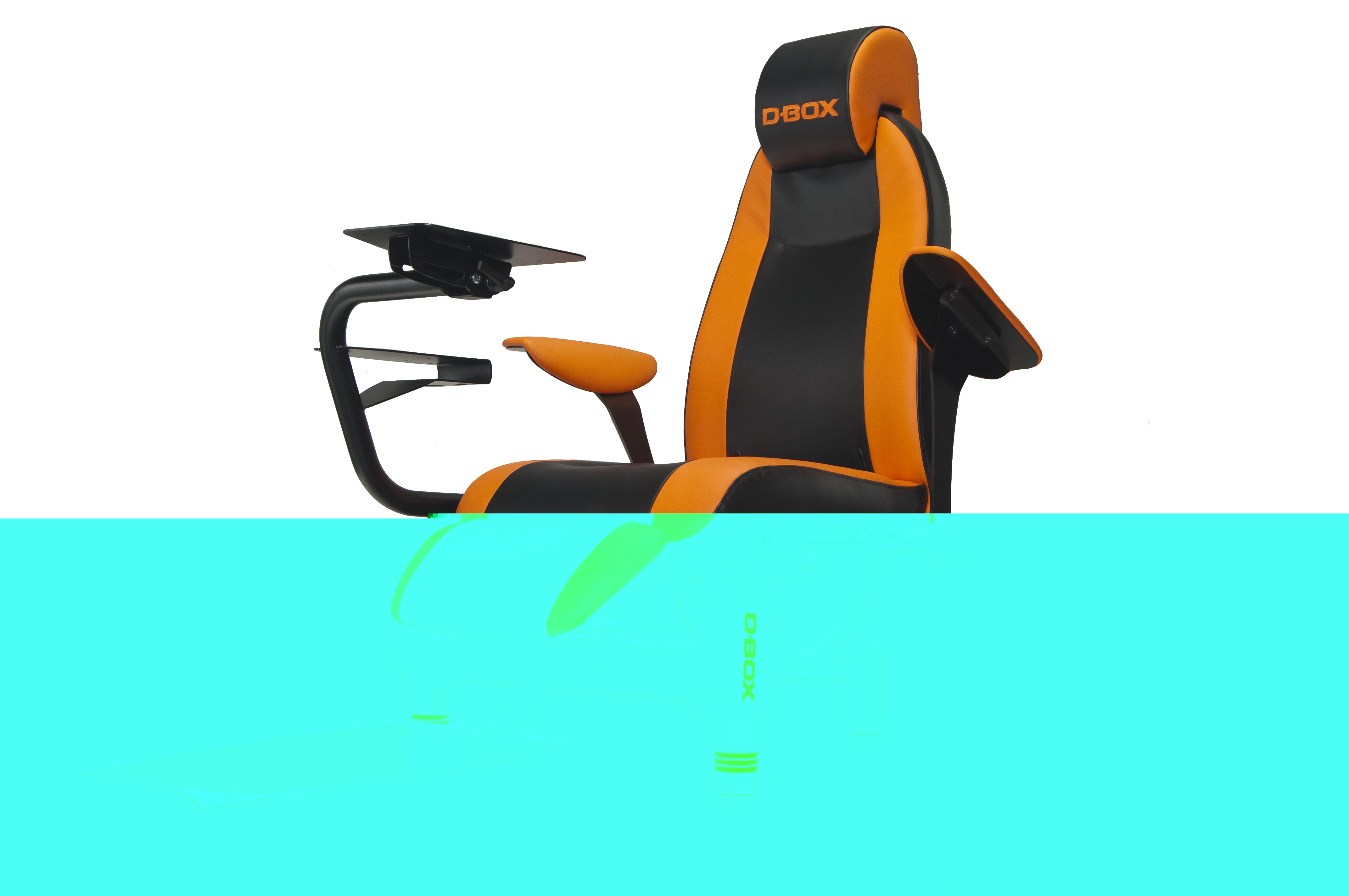

But i will keep this thing in mind: viewtopic.php?f=60&t=242
If my first attempt to build a 2DOF with my Playseat works fine I WILL, someday build such a thing with 360 degree rotation.
tronicgr wrote:I remember them from the old * site. They were using the x-sim software but never shared their work on hardware, instead they went commercial. :evil:
And because of this everyone should be able to copy their concept with a clear conscience :twisted:
