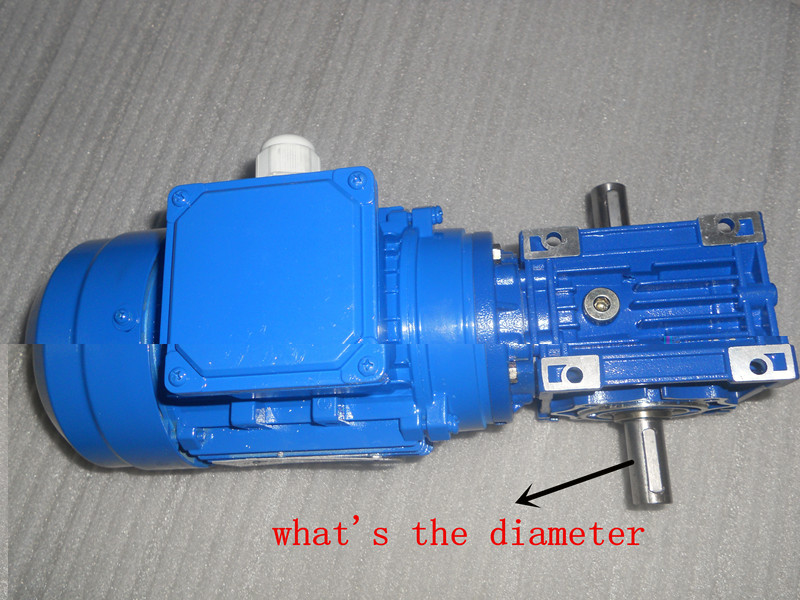

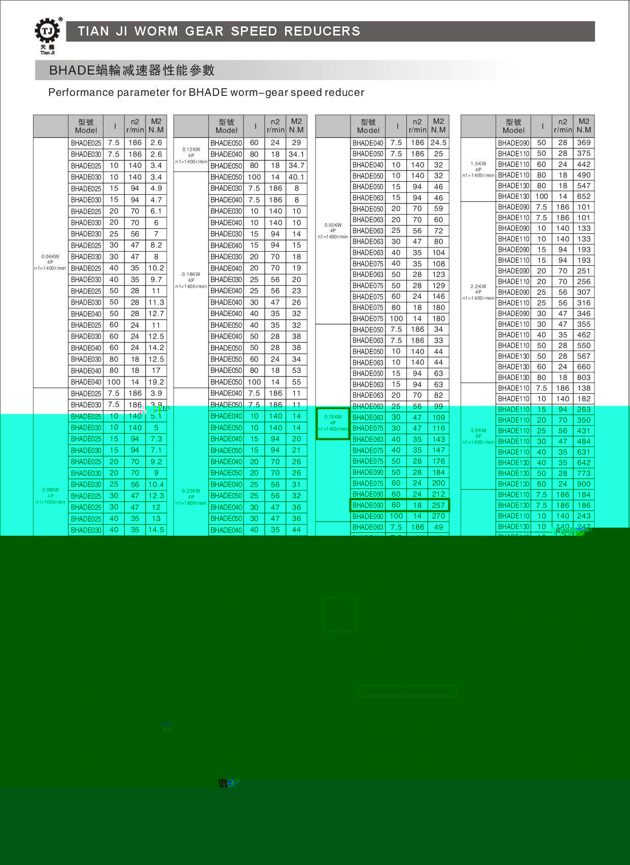

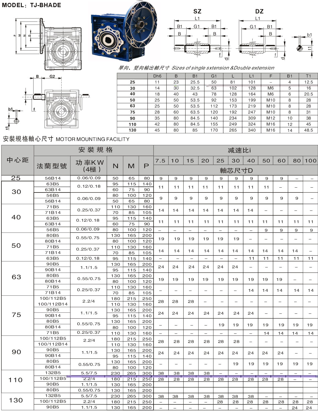

That would be very welcome. I'm currently orientating myself on AC worm gearbox motors for the Thanos 6DOF configuration in the Chinese market.
I think I might get them much more cheaper than here in the Netherlands. And most probably also with more precise specs for optimal 6DOF configuration.
I've attached a spec sheet with directions from the vendor what gearbox motor he could offer for me. Maybe you can have a check. Would be most appreciated :-)
Motor + gearbox
Gearbox spec sheet
Motor Spec sheet

I can tell you about these worm gearboxes will be fine. I have used them before on 6DOF with no problem.
https://www.youtube.com/watch?v=V9lN9RIt7UI
Fabian did use similar ones as well:
http://motionsim.blogspot.com/2014/06/6dof-fabi-progress-update.html
http://6dofabi.blogspot.co.uk/2014/03/project-start.html
