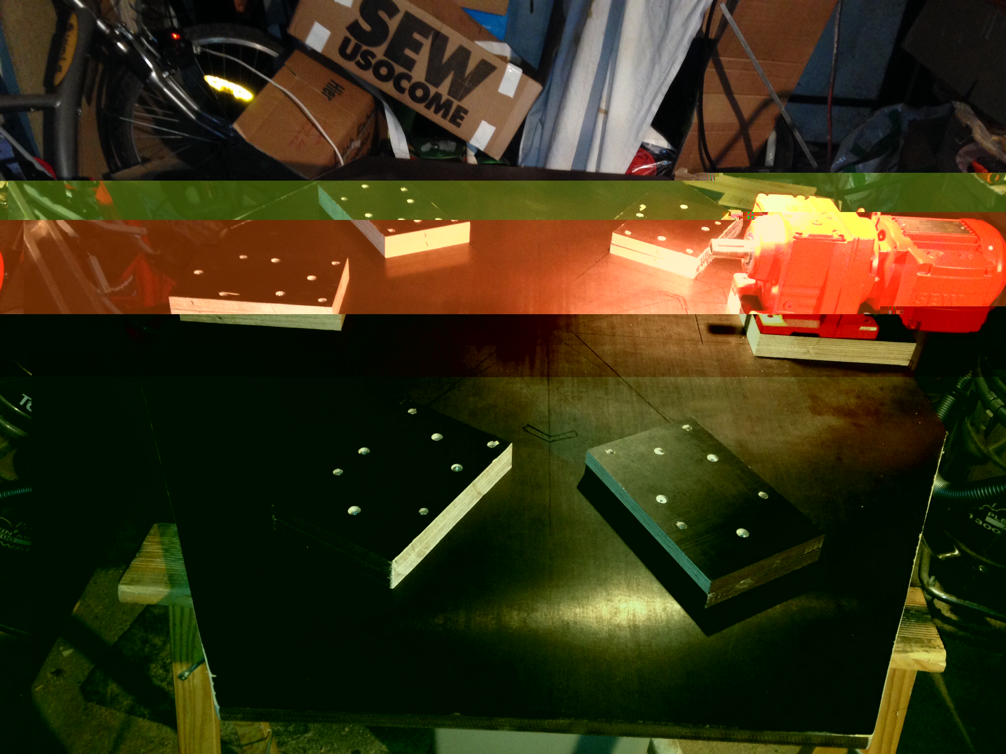

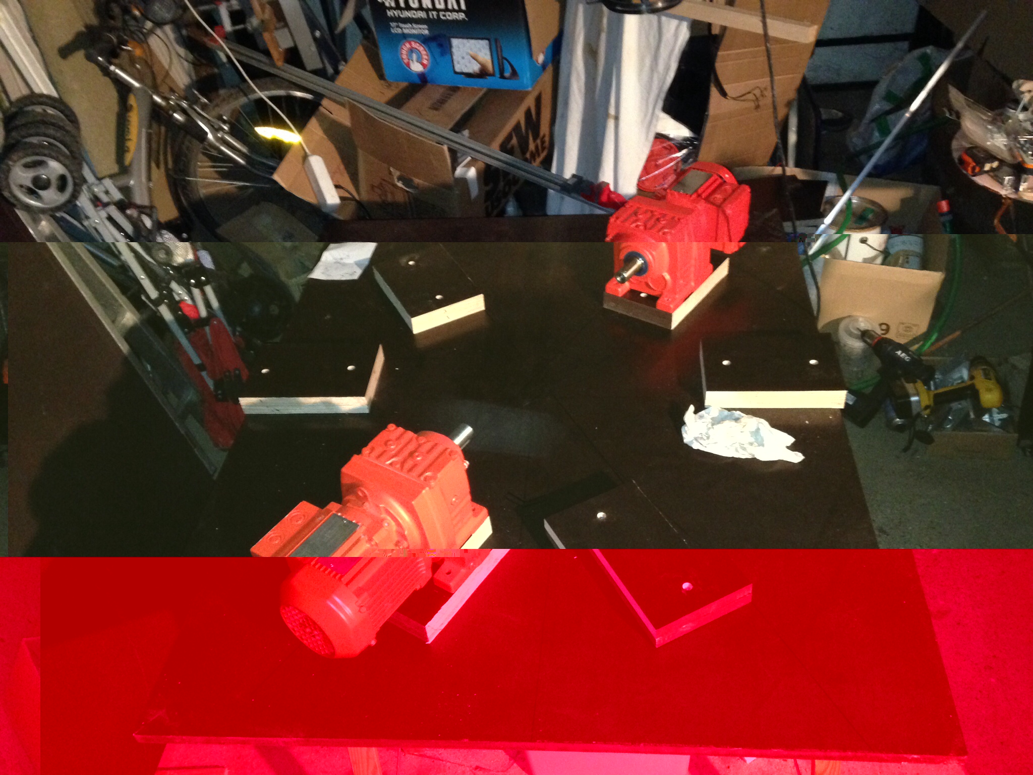

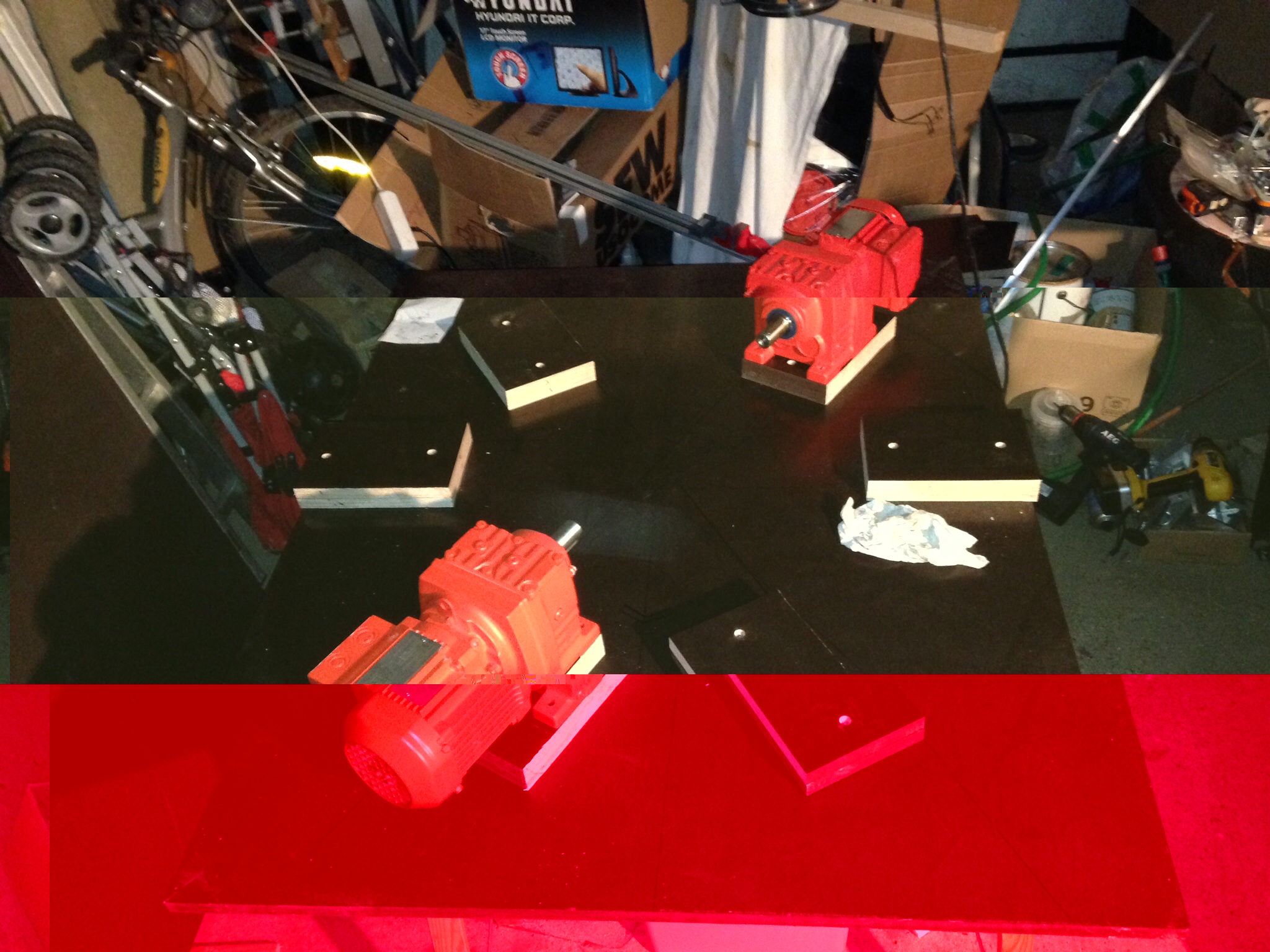

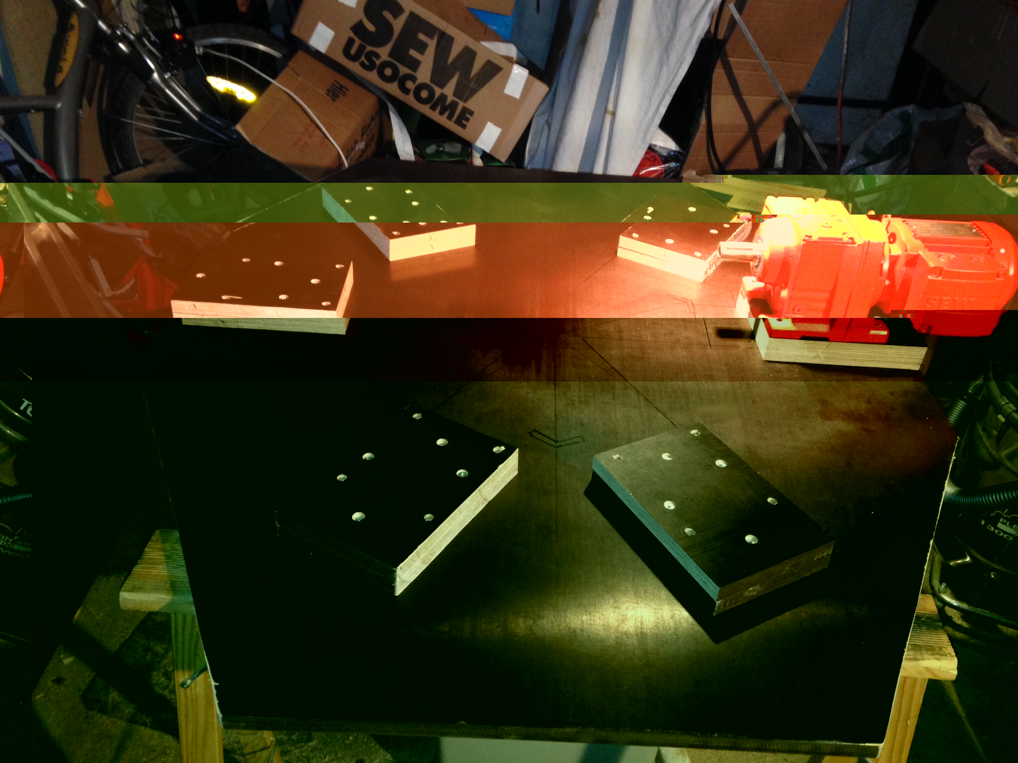

Hello,
I am building a 6DOF racing simulator.
The motor/gearboxes I got are quite long at 25" from front to back.
I see that all the Stewart platforms typically have the gearboxes towards the center of the simulator, with the motors on the periphery.
Would it be OK to position the motors so that they are all "butt to butt" in a star configuration?
The gearbox outputs would be therefore located on the outside of the base frame.
Is there a rule that shows exactly how the gearbox output levers have to be positioned in relation to each other?
The gearboxes are attached to the seat platform 2 by 2.
Do the motors/gearboxes have to be positioned in a specific manner?
Can they be parallel?
I am thinking about this other design which looks very promising from a member here:
2706
I would simply reverse the motors so that the outputs are towards the outside, instead of the inside.
I notice his motors are parallel to each other, but in the Ckas design, they are not:
2352
Is there a better way to place the motors?
Does it matter?
Thank you!
