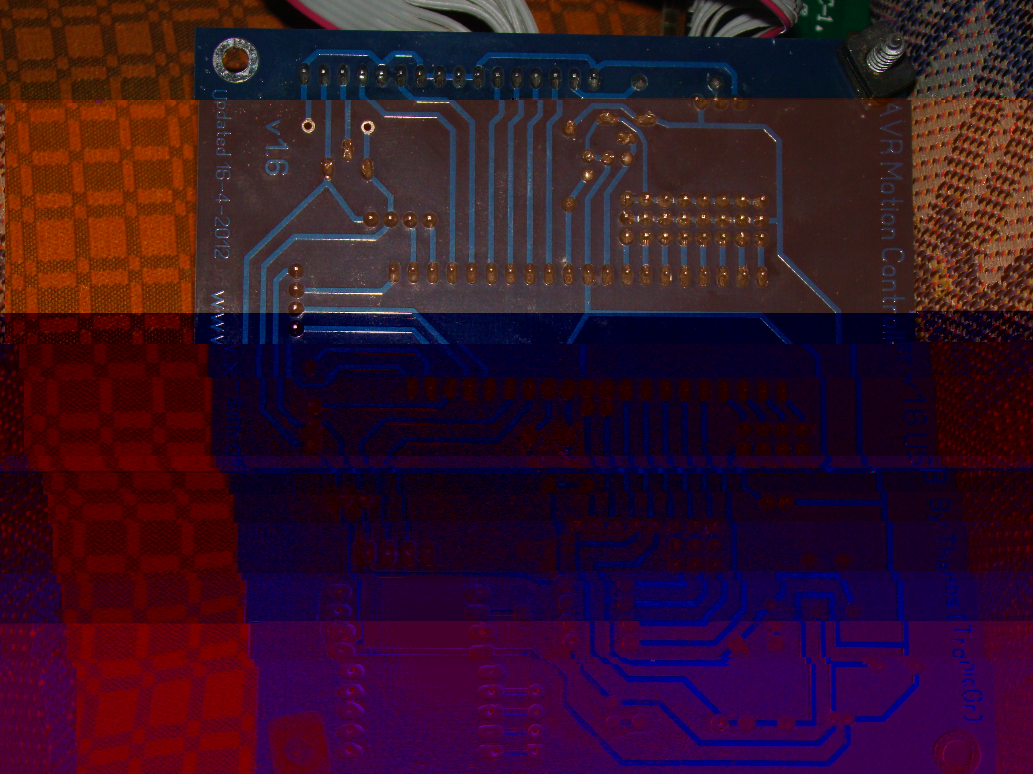

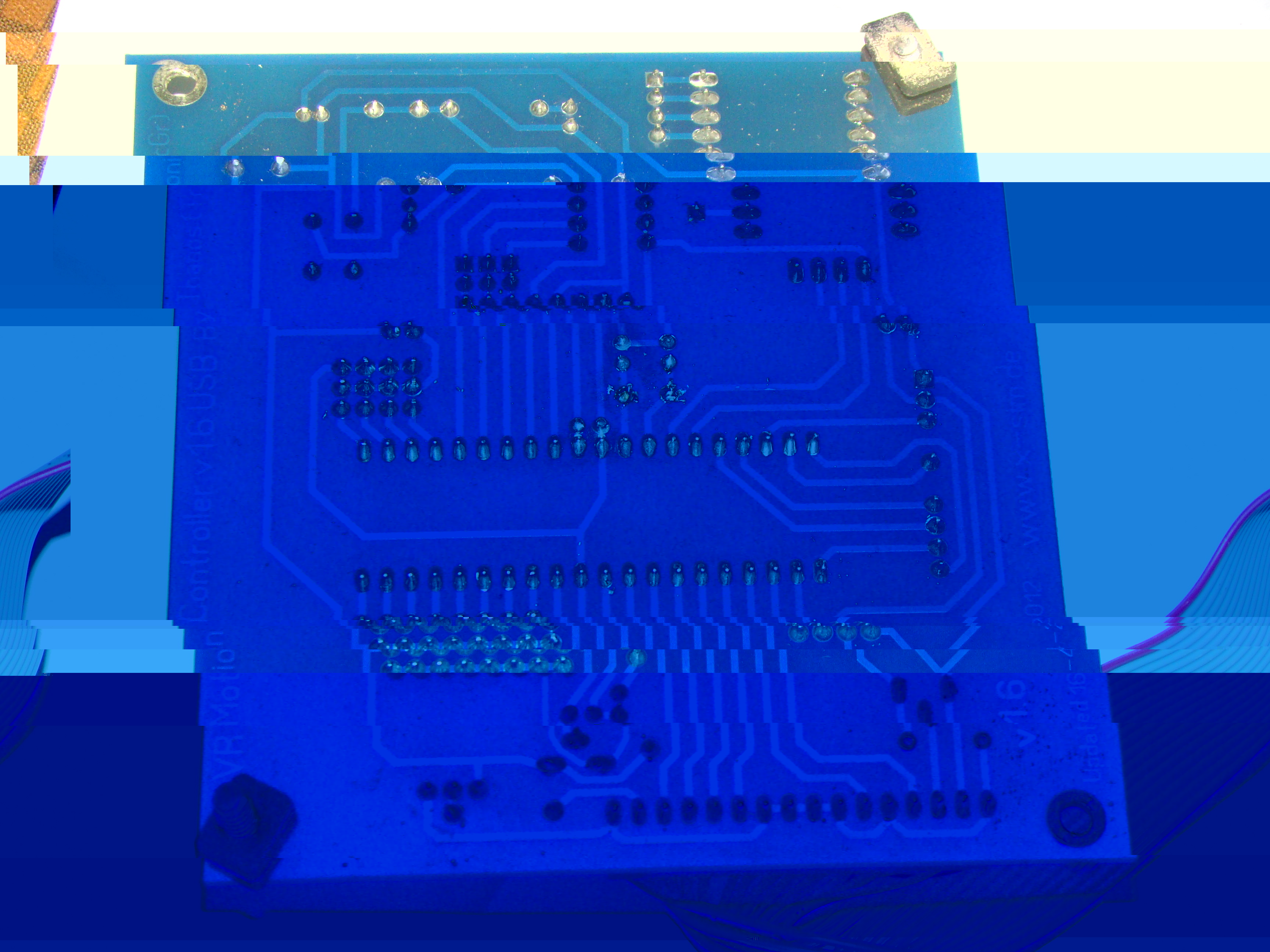

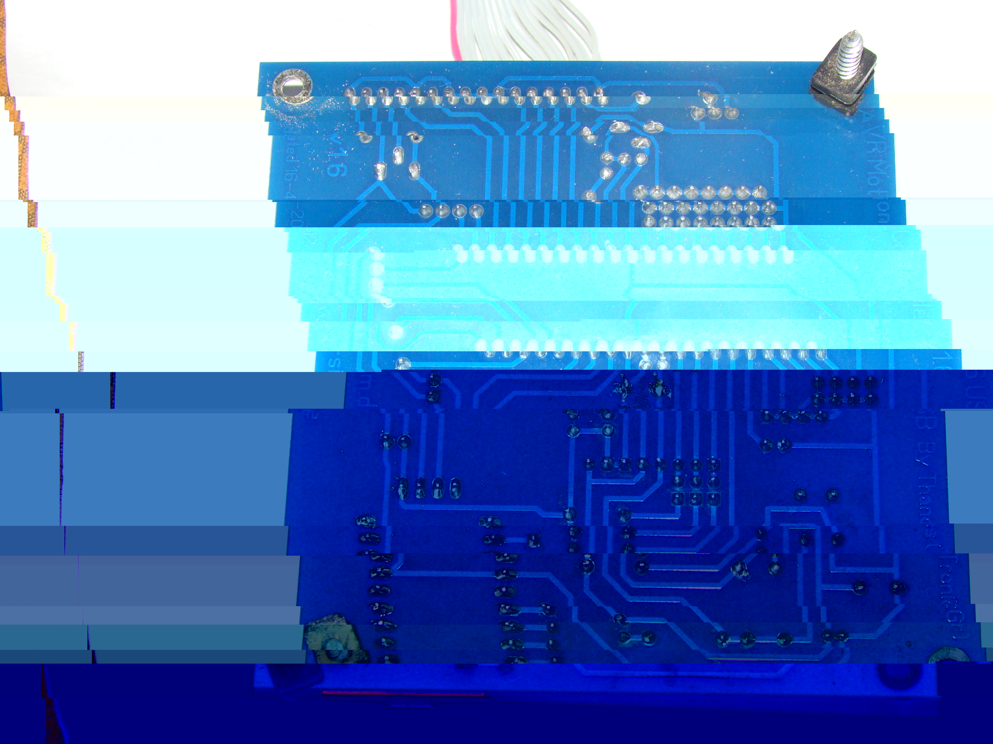

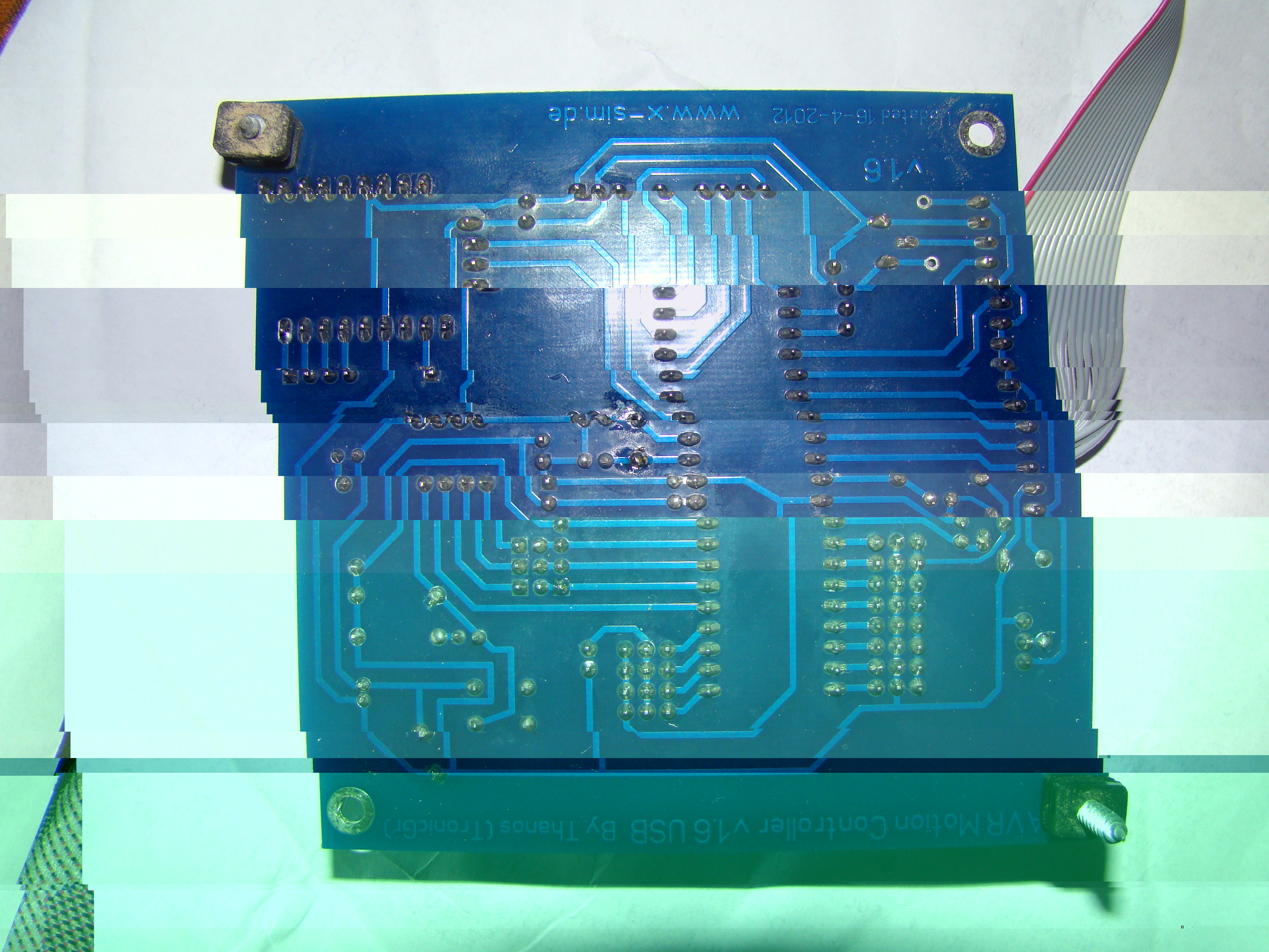

I got a new set of pictures ,hope you can see what wrong with it
if you need a special picture or angle le me know
thanks

I don't see anything wrong with the board...
Look at this video and see if you can adjust the limits with the potentiometer placed on "pot3".
Also make sure you connect the potentiometers correctly. The order of the pins are [Wiper] - [+5v] - [Gnd] with wiper pin being close to the atmega644 chip.
