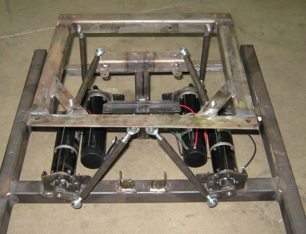

Tyrion wrote:They are 24V(for trucks and buses), I think they should be fast enough also. But I'm not sure if they can move each one axis seperately, since they must move whole weight of the moving construction + person per axis.
What about using 4 standard car(eg. vw golf) 12V wipers, because I saw that wiper motor simulators are noticeably slower than actuator(SCN5) ones.
So you suggest pololu JRK , amc1.6 + h-bridge or New Arduino + h-bridge project?
I have attached screenshot from my (quick sketch)model in Catia, but I think there could be too much stress on motors or even frame if I cramp motors under the seat like that without much needed leverage.
What do you think? Maybe I should use 4 motors, each on opposite sides of one axis, to releave the stress a little?
Thank you for your answers, since I really must know that before I start buying materials.
consider 12v boat winch motors if you want lift on a frame.
With JRKS, they will work fine.

12v big worm gear motor
http://www.motiondynamics.com.au/worm-d ... -180w.html

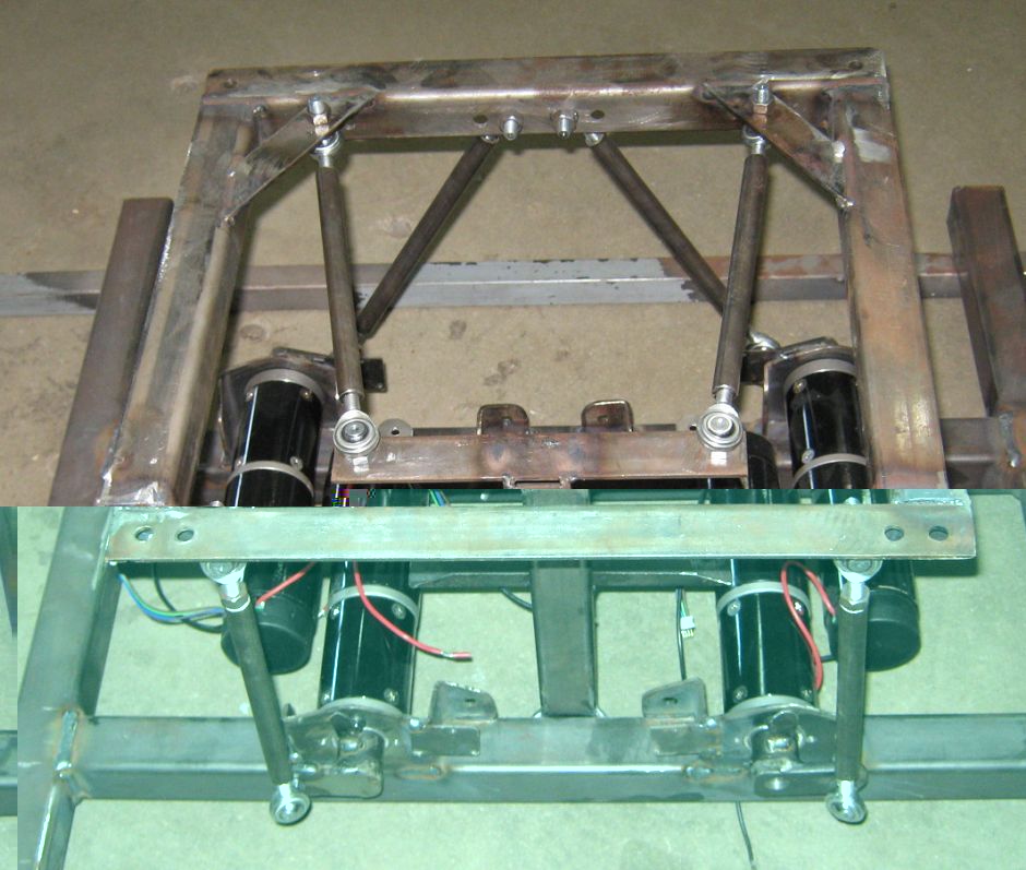

id be very surprised if a car wiper could do , even 4 of them, consider bigger motors.
that ferns sim has an airbag under it with the wipers
he did a rebuild of the frame with 24v motors without an airbag. I reckon 12v motors would do just as well.

Thank you a lot motiondave. This design you sent me (in pictures) is really what I designed in Catia before I had any clue to start, but with four motors.
And yes you have that right car wipers couldn't do job properly I'm now going through catalogs for 24v industrial solution, I just need to find reductor that would fit them.
Great job man! Dave if you find yourself in Slovenia contact me, I owe you a beer:) Could you just please give me link to where you got pictures of the simulator in pictures you posted above. Thanx!

Is that fern's new simulator in pictures? I mean has anyone tested that design and can confirm it works.

I dont know if its tested, although I did see a video somewhere of 180kg on it and moved with ease, mind you, he had 2 rear hatch gas struts to help hold the load. Under 120kg, it seemed to do fine without them.
