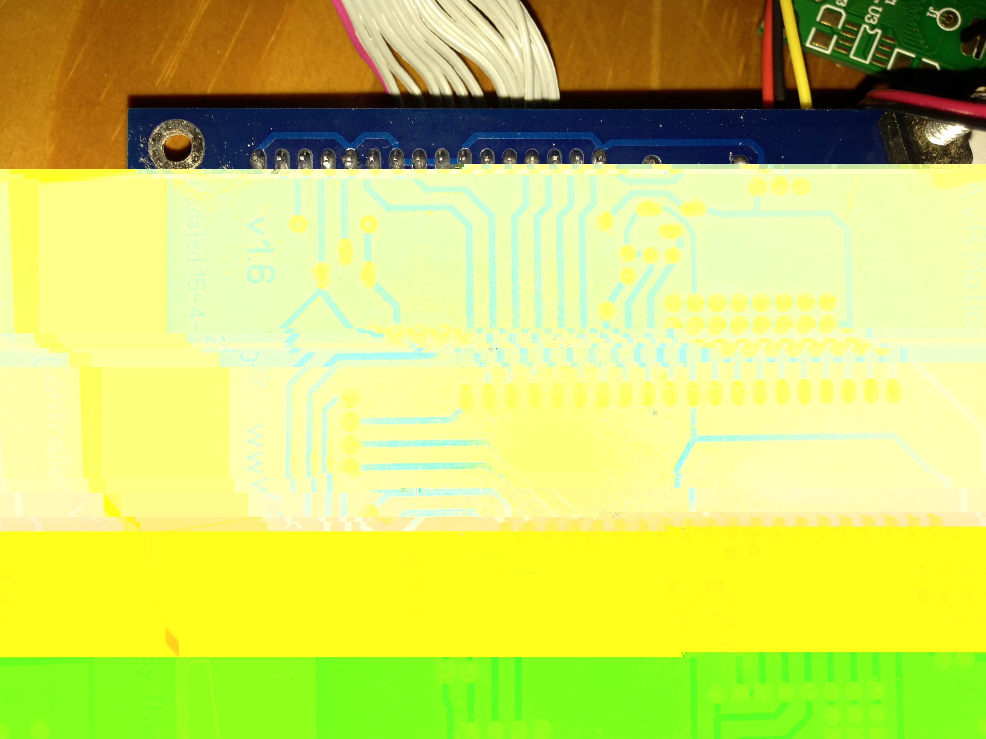

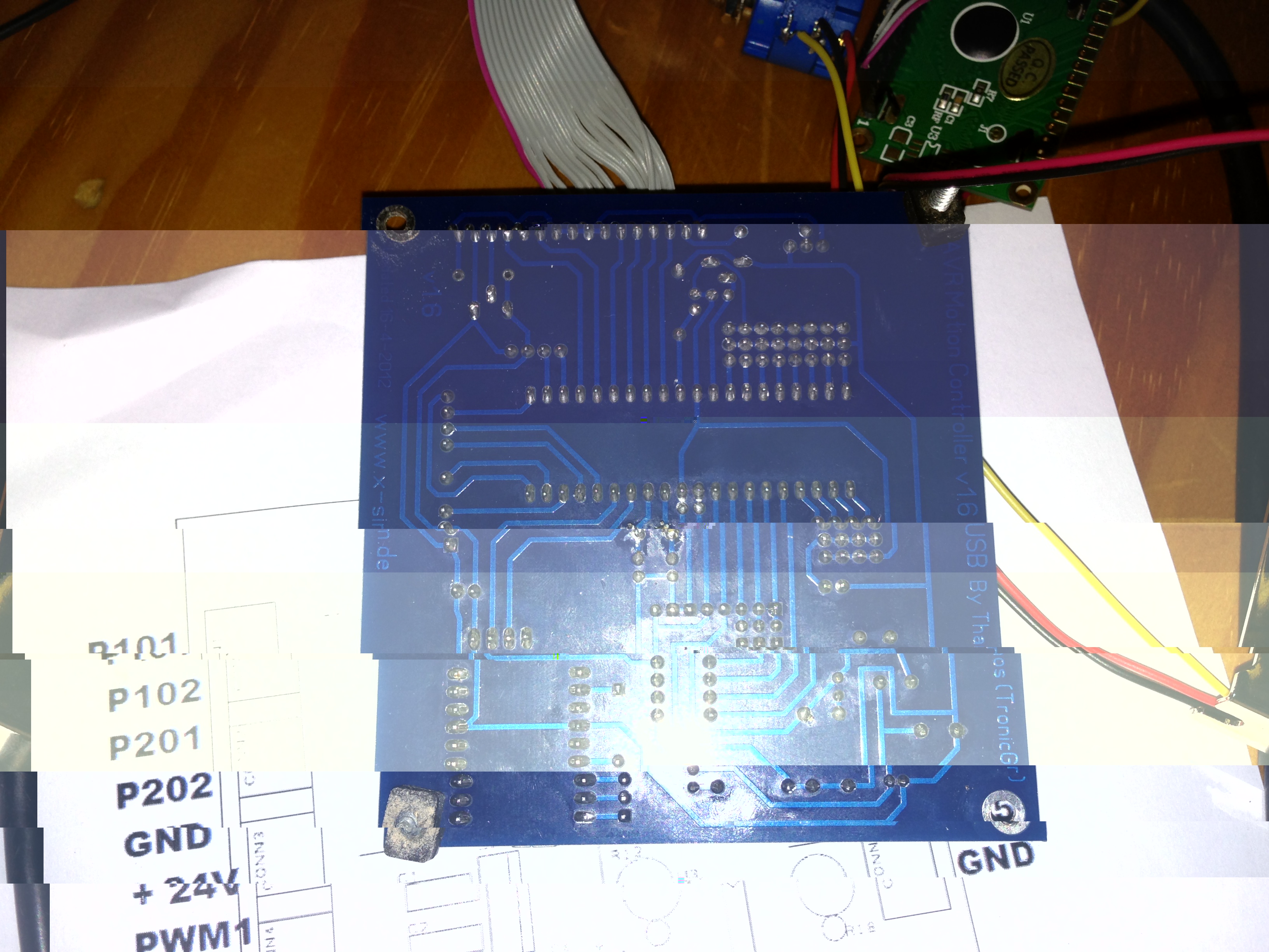

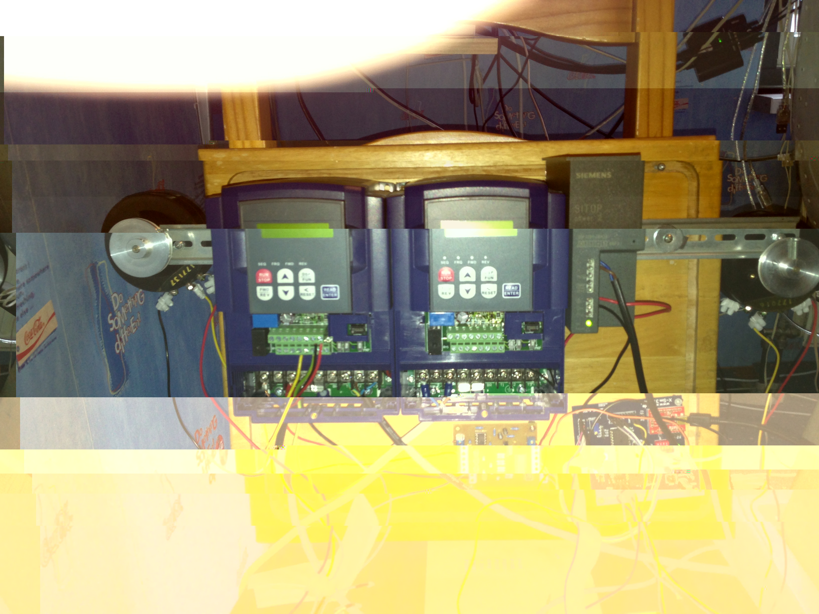

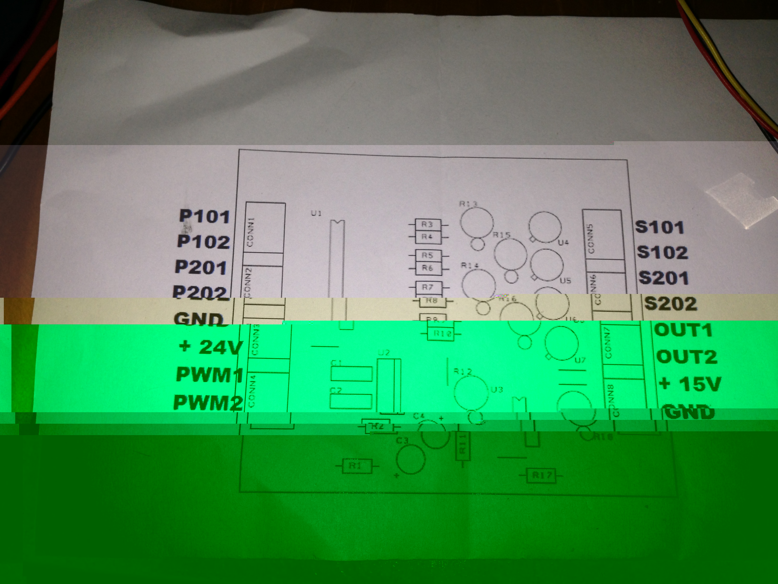

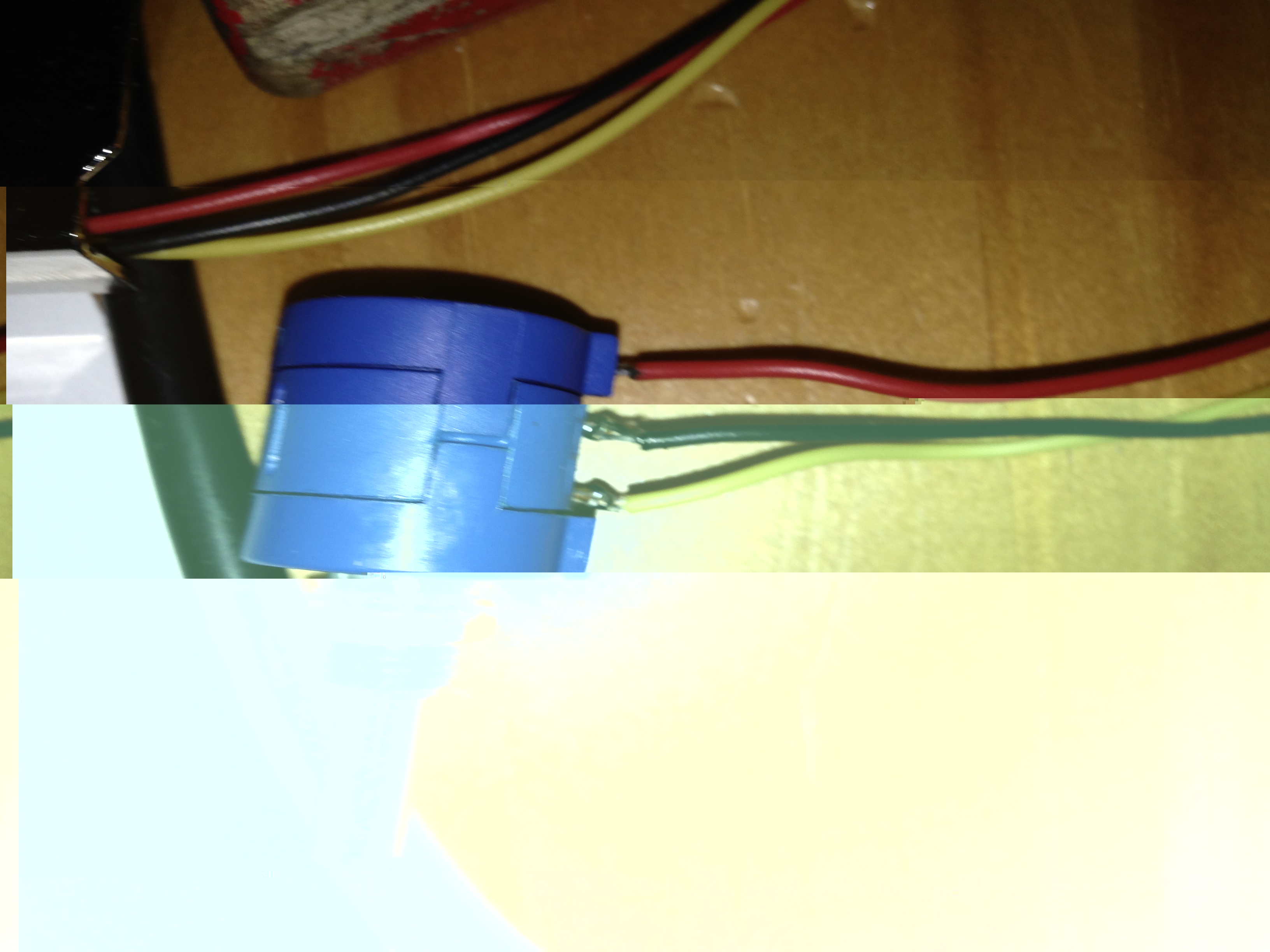

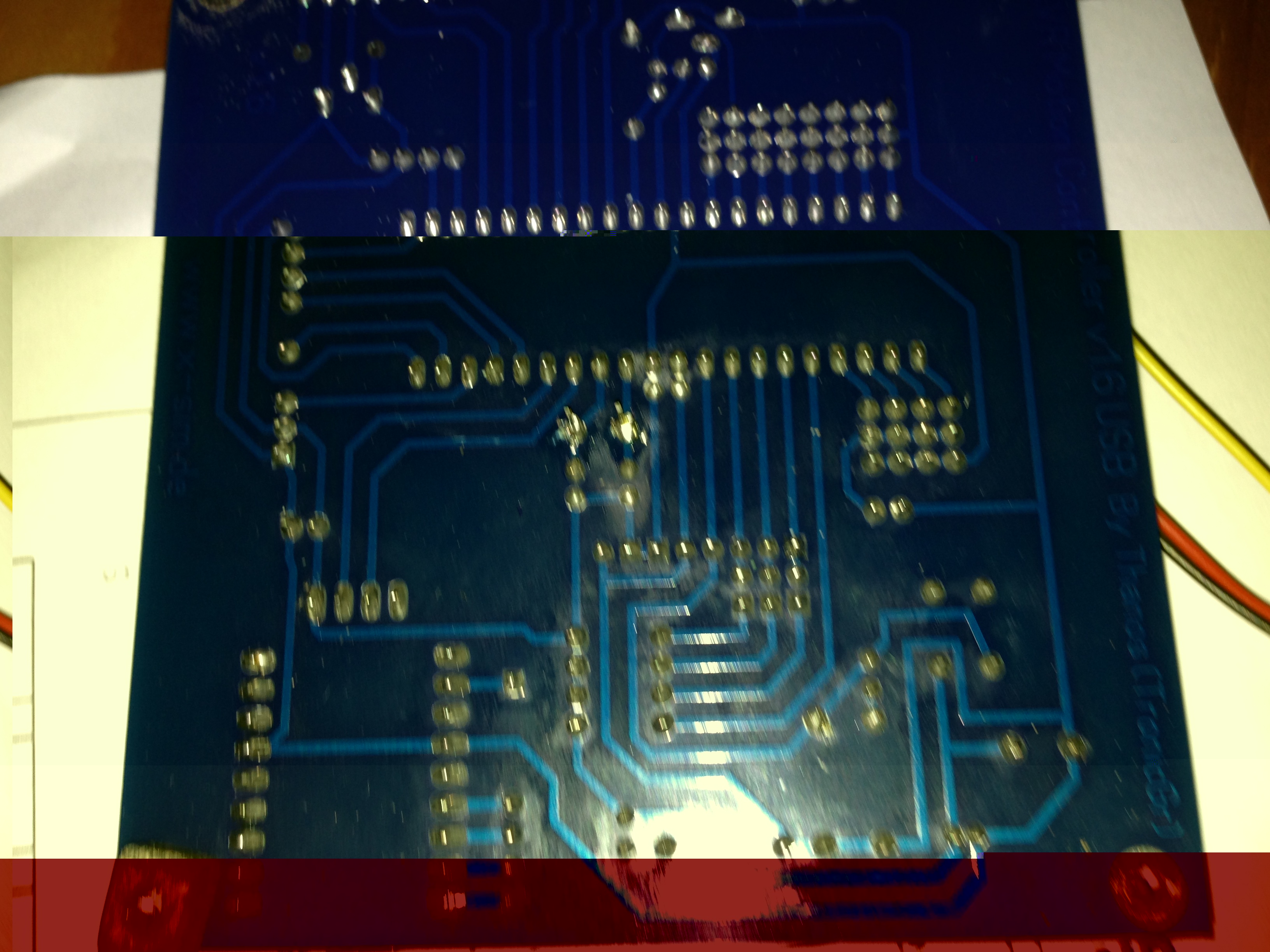

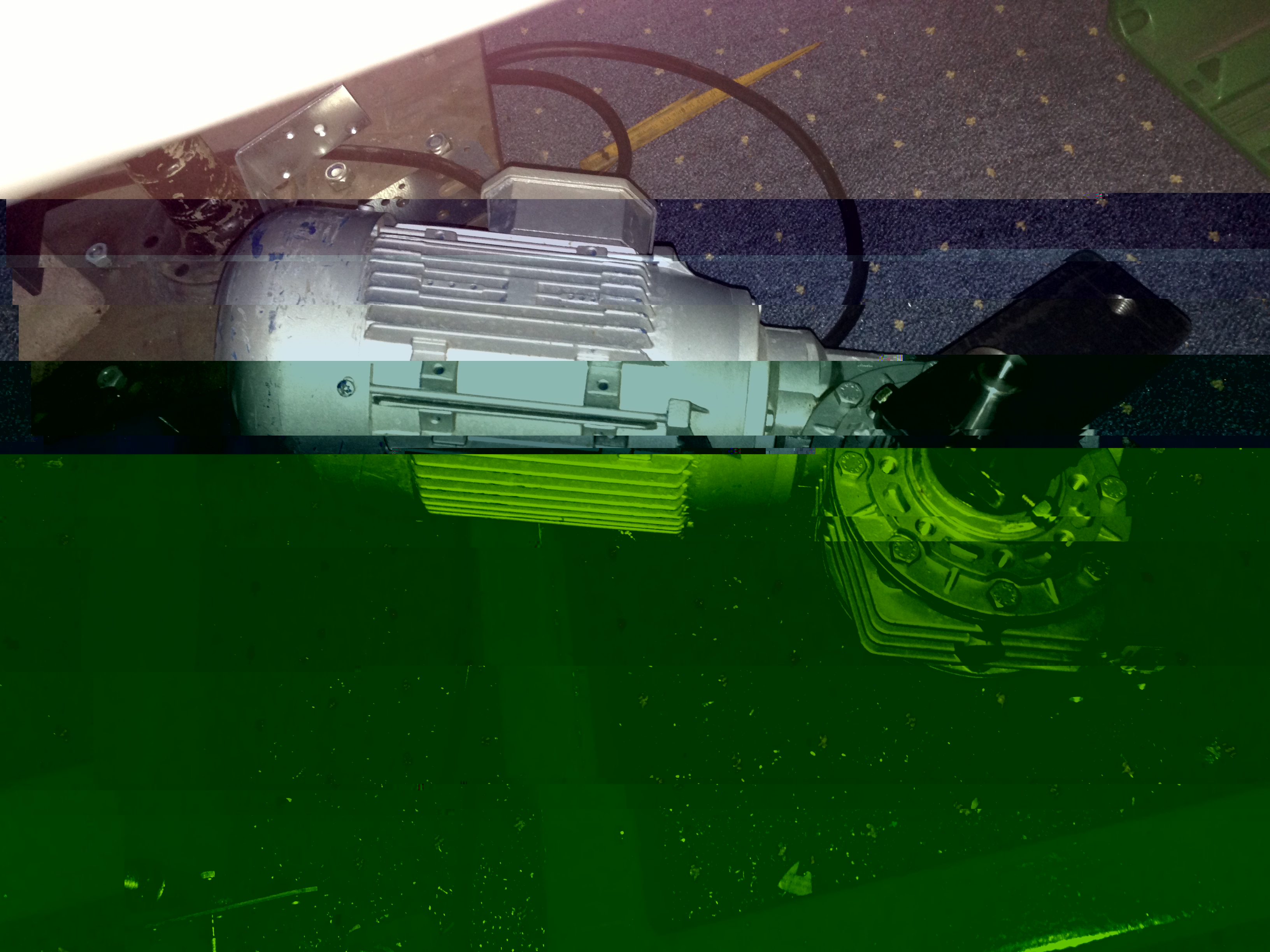

Postby kermit » Wed 26. Jun 2013, 21:11
here are some pictures
please notice I changed the crystal
I have also a pic with the set up for fine tuning
If everything works it will be placed in a ventilated case
put in also a pic with one of the 2 motors and gearbox
second board is made with drawings from vicpopo please see e diagram on first page
Henk

Postby tronicgr » Fri 28. Jun 2013, 14:49
I'm trying to see the problem but the photos of the top and the bottom of the AMC1.6 are blurry...
